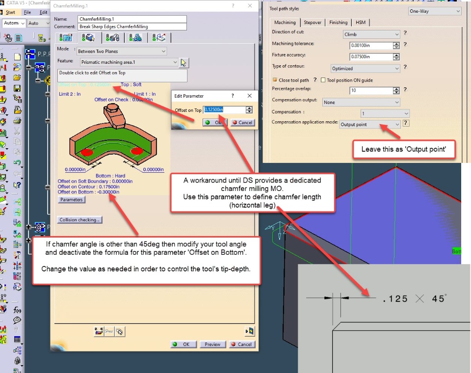

Attached are files containing a machining process for chamfer-milling using conical end-mill with Profile Contouring MO in V5.
