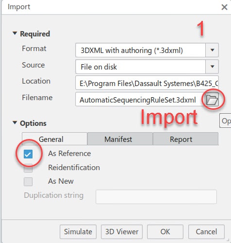

How to use 'AutoSequencingRuleSet.3dxml'
'AutoSequencingRuleSet.3xdml' is a file located in your installation folder '.......\\Program Files\\Dassault Systemes\\B425_Cloud\\win_b64\\startup\\Manufacturing\\Samples\\AutoSequence'

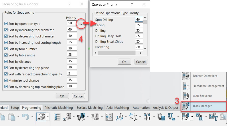

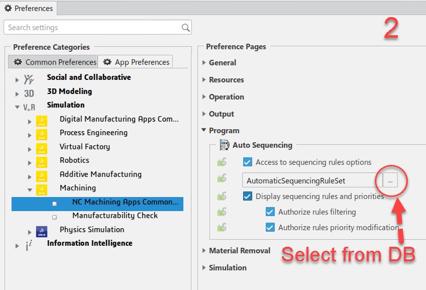

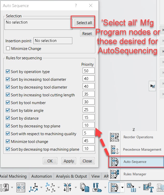

This is used to automatically reduce tool changes and consolidate machining operations that use same tools. This capability gives you the ability to choose your options and set priorities when the rules are applied. Below are few images that illustrates how to set this up and apply to your process.
