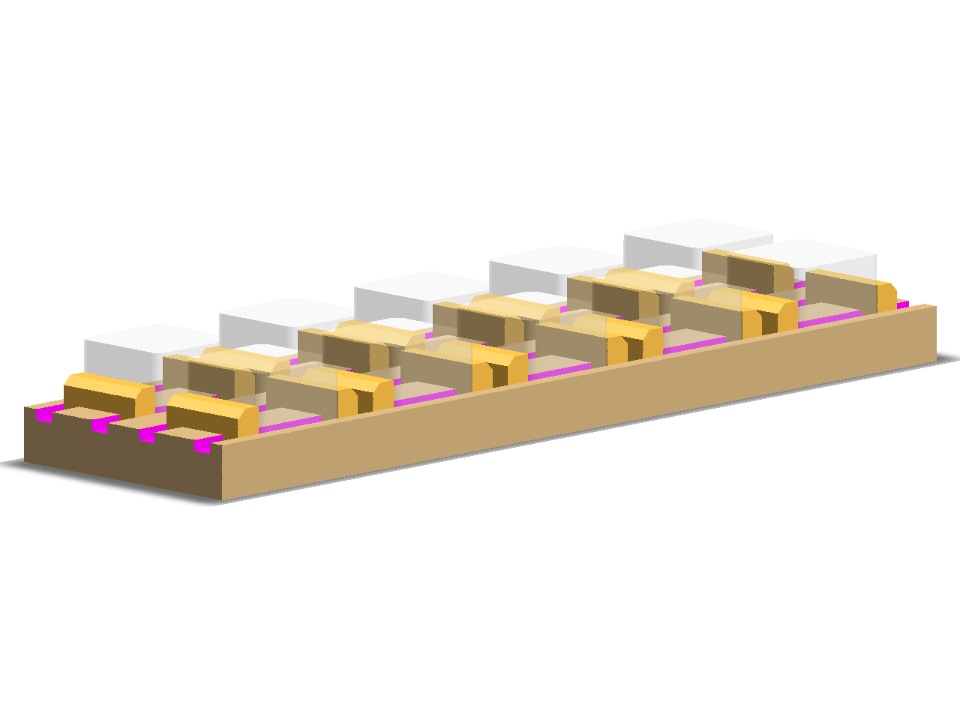

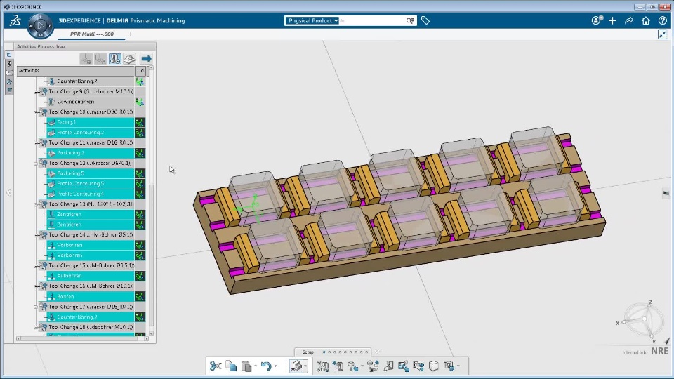

Reuse is a very powerful feature that will let you reuse machine, tool paths, tool, approach/retract macros, Post processor if associated to the machine , from a proven process. With REPETITION feature in the contextual menu, it augments the REUSE value to the next level. Please see video below and data attached for your convenience. REUSE-REPETITION combo saves significant time in programming.
NOTE: 3DXML data attached below included 2 templates Platte1 and Platte2 and a Empty MultiPart PPR.
