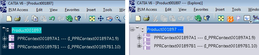

1. Insert PPR Context into a Product.

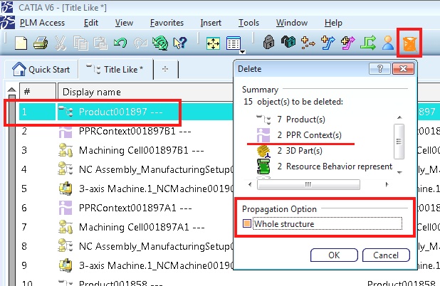

2. In the Search Result window, select the newly created Product, click Delete. Select the Whole structure option to propagate the delete to the entire structure.
3. Whole Product structure containing PPR Context(s) will be deleted when you confirm the operation.
