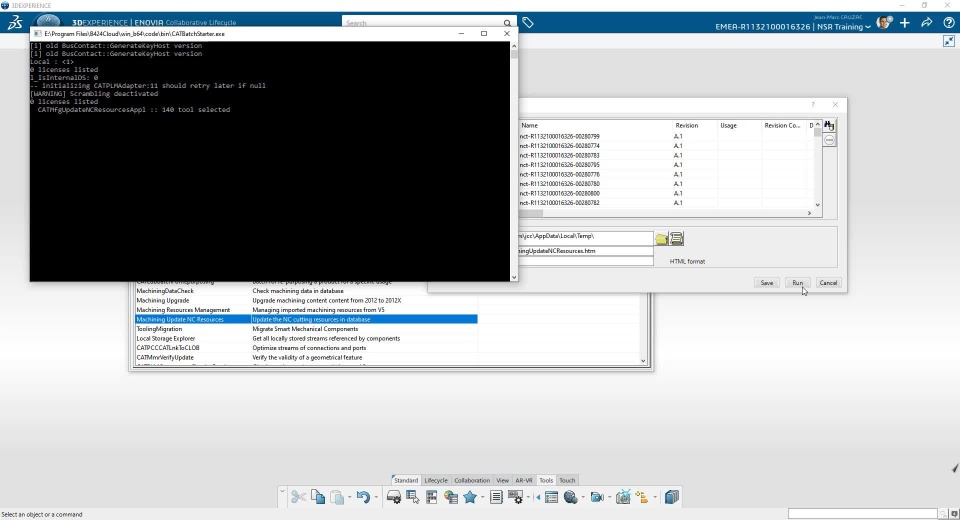

How to migrate tools in R2022x by Utility, Collab Space by Collab Space
The Utility (or batch mode) can be used to migrate the full database in one run but if you want to do it Collab Space by Collab Space to have a better control of the execution or to do it step by step, it is possible thanks a 'magic word' to setup before to launch your session in your ENV.txt file : MFG_UpdateNCResources_Select=1
This declarative word will add some additional options to the standard execution Utility named : Machining Update NC Resources.
