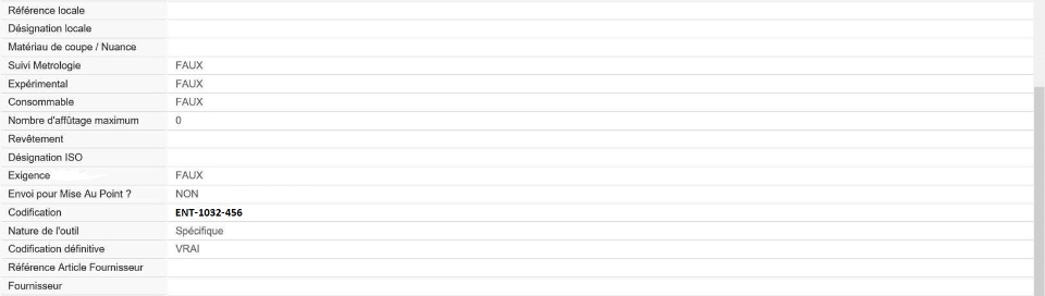

If you create some attribute on a (tool, Insert,Holder ,Machine  …) and you need to use/extract this attributes on the APT file.
See below the example
Name of the Tool:
Example list of Attributes on the tool (Codification):
In ths example you will write in the PPtable
PLMTOOL_ENT_1032_456
You can use this list of  parameter directly on the PPtables:

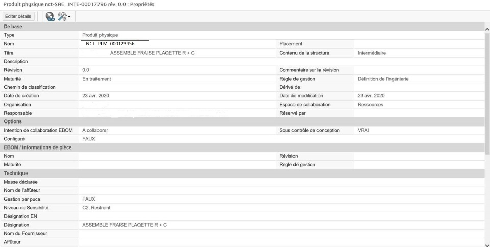

In the PPtable you can add the name of the attribute in front of the key words.
PLMTOOL_     if the attribute is associated to  the Tool
PLMTASM_     if the attribute is associated to a  Tool assembly
PLMINS_         _     if the attribute is associated  to a iinsert
PLMHOLD_    _     if the attribute is associated to  a Holder
PLMMACH_   _     if the attribute is associated to  a  Machine
