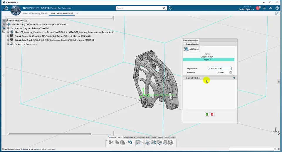

How to define Multiple REGIONS for Additive Manufacturing
REGIONS can be defined by defining separate Bodies in the product structure. This video below shows that the bracket part is sliced in Part Design for UPPER and LOWER halves and those bodies are used to define separate REGIONS. This will allow users to define varying scan paths strategies and layer heights for the 2 sections.
