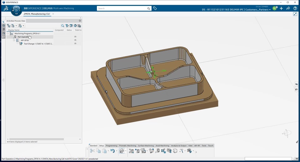

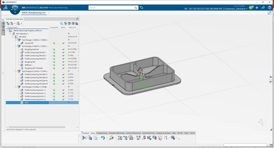

How to create ‘Intermediate Stock’ (result OP20 => Stock OP30) and how update it if OP20 modification ?
It is possible to create ‘Intermediate Stock’ / ‘In Process Model’ after the toolpath simulation.
A ’cgr/polygon’ file is created and can be used in another Manufacturing product.
In the pdf, I describe the process and I have recorded two videos
  • How create the IPM the first time form OP20 to OP30
  • How propagate the modification if you modify OP20
The result is a polygon file, it is not an exact solid
