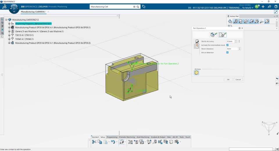

How to create AUTOMATICALLY ‘Intermediate Stock’ (result OP20 => Stock OP30)?
To complete my two previous posts on Multi PO methodology
Is it possible and How create a multi PO manufacturing cell ?
How to create ‘Intermediate Stock’ (result OP20 => Stock OP30) and how update it if OP20 modification ?(This method is similar to V5 methodology)
I propose to present another capability to manage the stock between PO.
=> It is a new possibility available in the 3DEXPERIENCE
This capability is very powerfull versus the “V5” methodology (previous post with intermediate result creation).
But according the part, the operations type/ number it can be no adapted.
If you have large MO, computed stock each time can be time consuming and the system check all the time if the MOs are up to date.
So if you have a lot of operation you will have to recompute all.
On my side,I start to use this methodology for turning of for “simple’ prismatic part (like in the pdf).
Methodology ​​​​​​​ R2022x ​​​​​​​ThoughtWorthSharing
