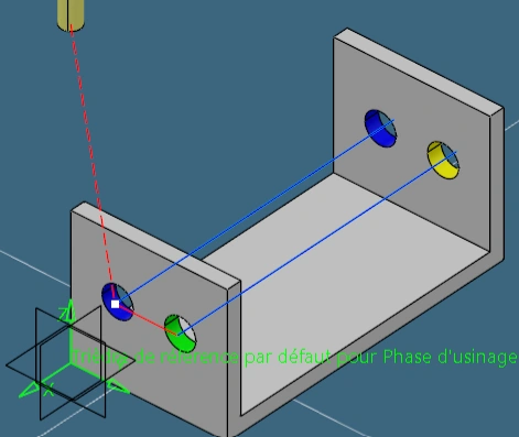

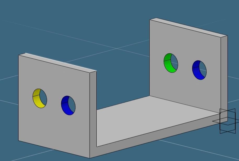

the two blue holes are the result of a single hole operation.
the two yellow and green holes are coaxial and the result of two different hole operations.

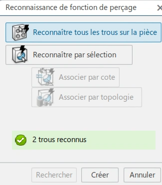

when I launch the hole, feature recognition
it recognizes only 2 holes

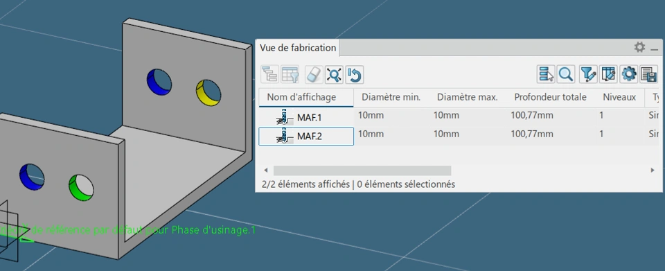

identified with the full width of the part as the thickness
and when applying an axial operation on the maf, it only considers 2holes
