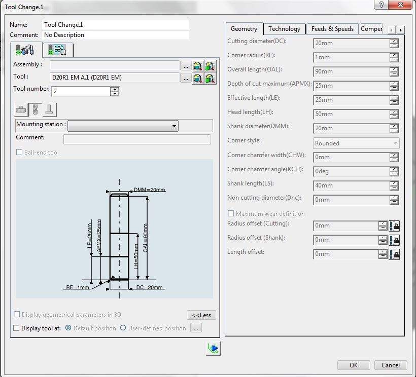

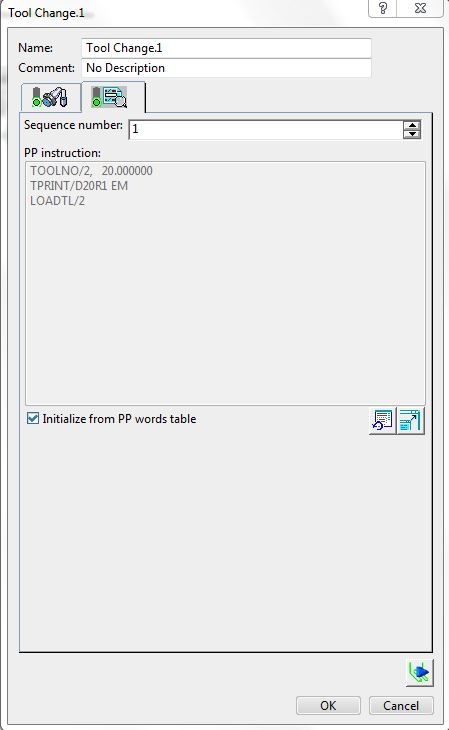

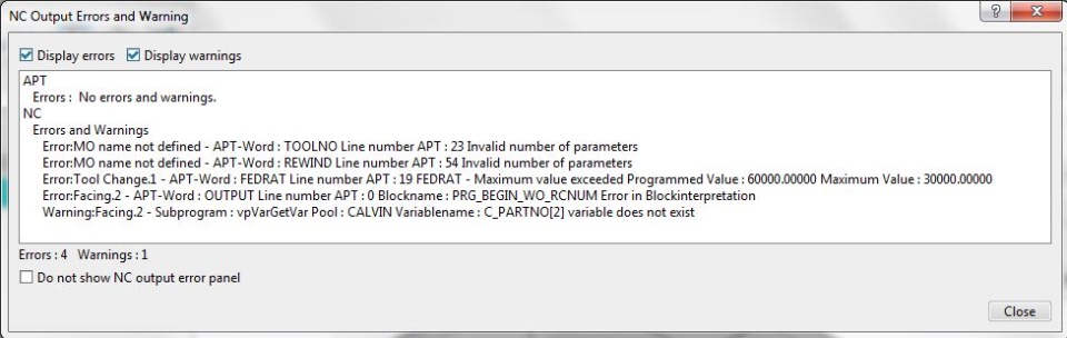

Hi all, fairly new user here. I am encountering some errors while trying to generate an NC file and would like some advice. The first error is that at the line TOOLNO in the APTsource file, the tool information is not registered in the PP Instruction, even though I have already configured the appropriate parameters. I have followed the exact same tool conditions as a sample PPR file given by my distributor, whose file works without warnings nor errors using the same PP file.

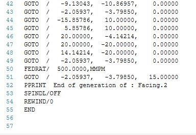

Secondly, the line REWIND/0 is generated near the end of the program, which is detected as an error as well. I have checked through the PP Tables and Syntax in User Guides but did not find any mention of REWIND/0.
