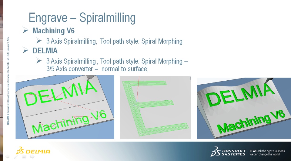

Engraving with Spiralmilling V6R2013x

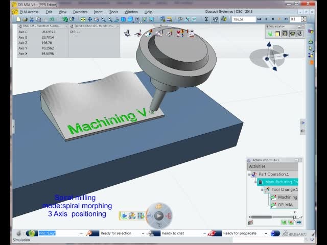

  • Spiral milling 3 Axis positioning with the tool path style:  spiral morphing to reduce the approach- and retract paths,
  • Spiral milling 3to5 Axis converter normal to the part surface tool path style:  spiral morphing to reduce the approach- and retract paths,
  • Before you engrave the text with Surface Milling, create the text with Part Design
