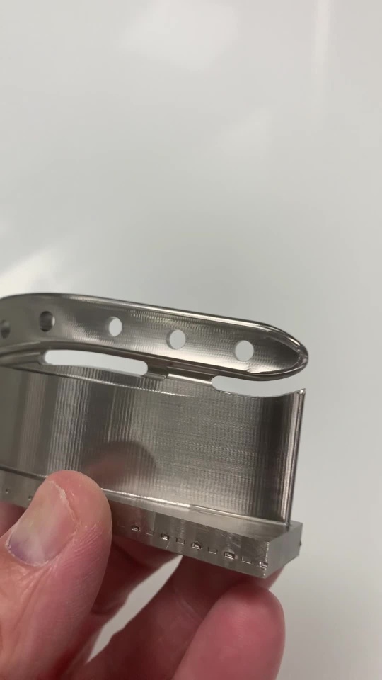

Just completed a mock-up designed bone plate component to prove out our tooling and machining strategies to a potential customer using the latest version of DELMIA 3DEXPERIENCE Machining software.
Very nice barrel tool strategy using our latest Barrel tools and some lovely new features within this software.
We achieved a cycle time reduction of 72% and very economical cost per part results.
Before you may ask. We left the ties on this billet so it could be seen attached!
