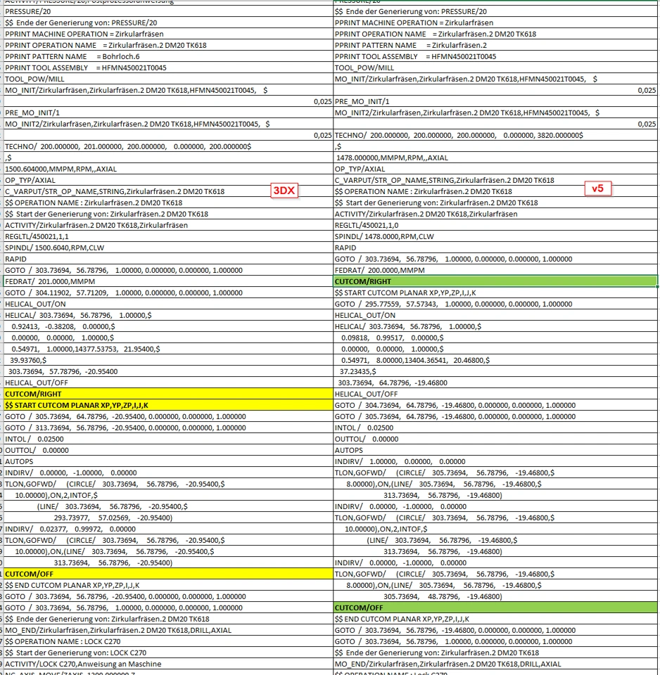

Hello Everyone,
In the following screenshot you can see that in 3DExperience the CUTCOM/RIGHT command is generated after the Helix approach macro, whereas in v5 it was generated BEFORE that.ANy idea why was this changed? Is there a way to adjust the settings to get an output similar to v5?
