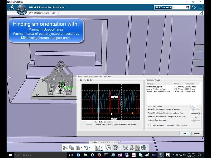

Optimize part layout and orientation :
In 2018x user can find a part orientation with Minimum Support area, Minimum area of part projected to build tray, Minimize internal support area. With a simple slide bar user can prioritize the criteria based on which the orientation is calculated. This is dynamic criteria prioritization slide bar which can update as the user slides the bar to left or right. This helps in getting to the optimized orientation and make decisions faster with visual confirmation of the orientation. Refer to the video below to see this feature in action.
