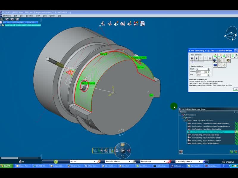

1. New strategies in 4-axis pocketing with added flexibility in programming
2. Hard Material strategies now available on 3axis SPIRAL milling, Power Machining and Roughing
3. Improved user experience in Mill-Turn : Using faces to define section by turning plane as guide contour

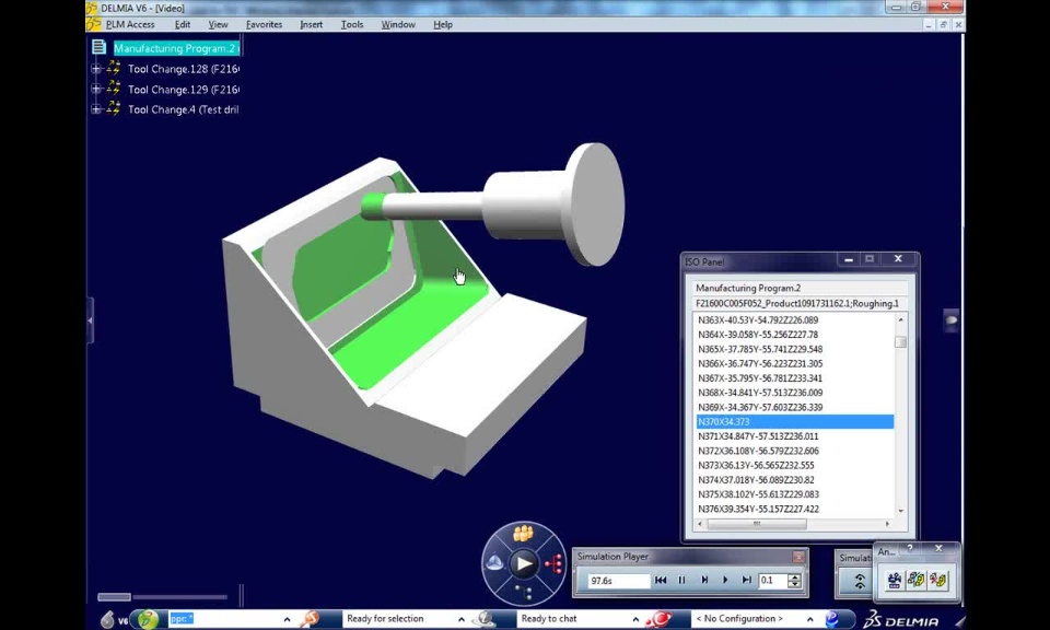

5. Import and Simulate non-DS generated NC Code. ( Legacy NC Code created on other systems )
6. Support for facing heads
7. Better control with simulation.
           - POSITION MACHINE BY JUST CLICKING ON ANY NC LINE
           - PARTIAL REPLAY OF ANY NC LINE
           - COMPARE AN ANALYZE PICK POINT INFORMATION AND TRACE BACK ERRORS TO NC LINES
             AND ALSO BACK TO TOOL PATHS AND QUICKLY RESOLVE TOOL PATH ISSUES.
