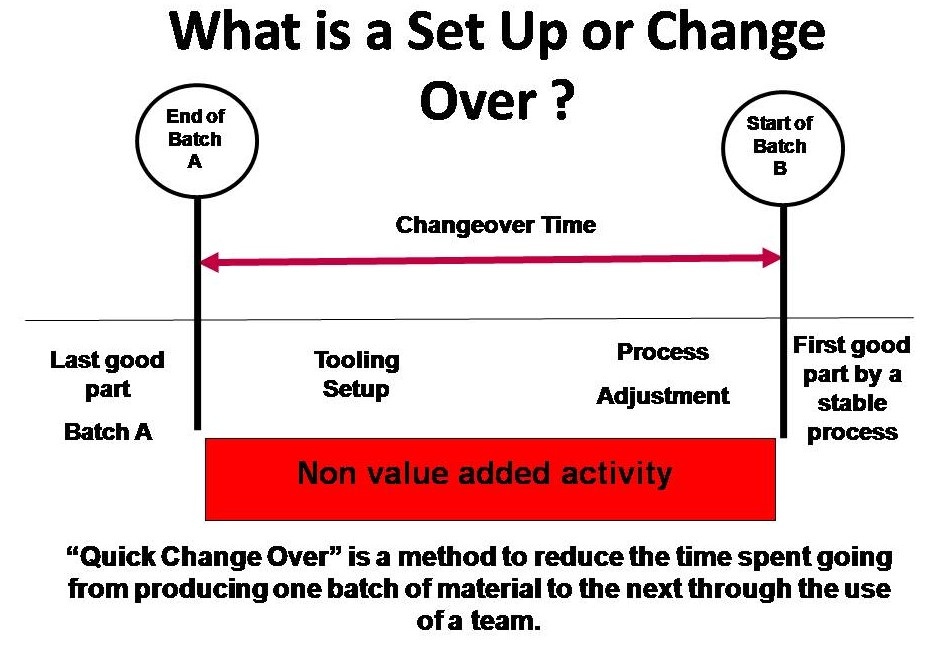

What is SMED (single minute exchange of die)?
SMED is one of lean mfg. tool kits that has evolved out of Toyota production system (TPS). It is a technique to deliver a quick changeover in less than 10 minutes. It will take a changeover that normally will take a few hours or even more and reduce it to one that will take single minutes. Through the use of these simple quick changeover techniques companies have reduced setup times from sometimes days to less than 10 minutes, often at little or no cost to the companies involved.
