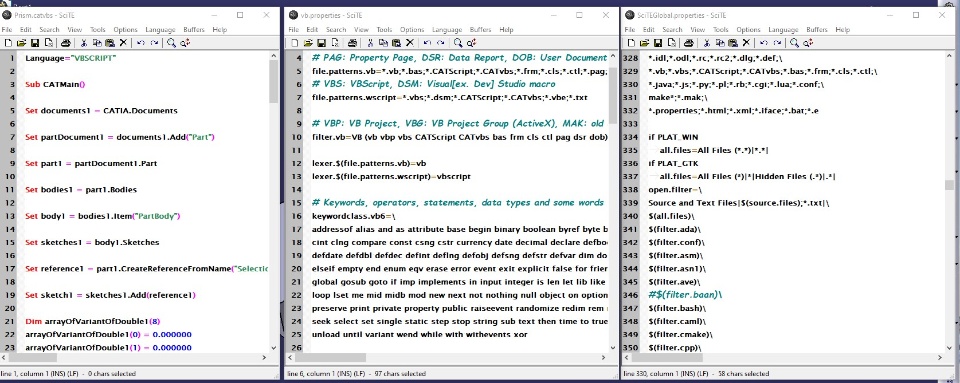

Another popular and small size text editor is Scite but also you need to modify two files to make CATIA scripts look like a VBS file is looking in the editor. You can also run the code directly from the editor as you will see in the video at the end of the article. If you decide that a small portable size editor is good for you, drop me a message and I will provide you those files.

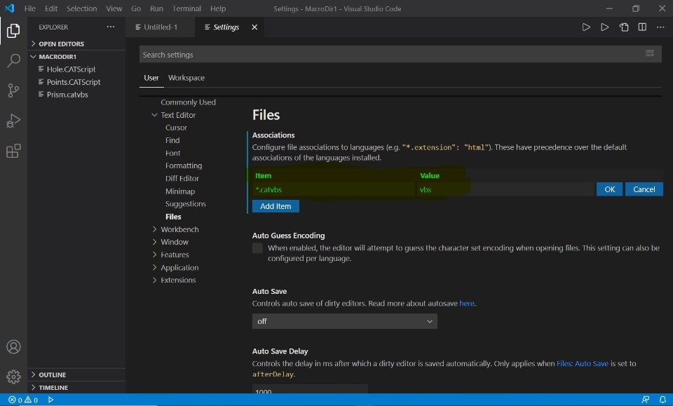

Its been a while since Visual Studio Code from Microsoft is available for programmers. A lot of functions and add-ons for different languages are provided so I decided to give a try.
Same like the other editors, you need to adapt the CATScript or catvbs extension to the most appropriate language, so I choose VBS.
In the editor, go to Files > Preferences > Settings and choose Files. Here you can choose how you CATScript or catvbs will look in the editor.

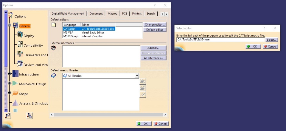

Personally I prefer not to assign a new editor in CATIA but if you want, you can do it in Tools > Options > General > Macros. Again, be aware of how you will debug your scripts...
