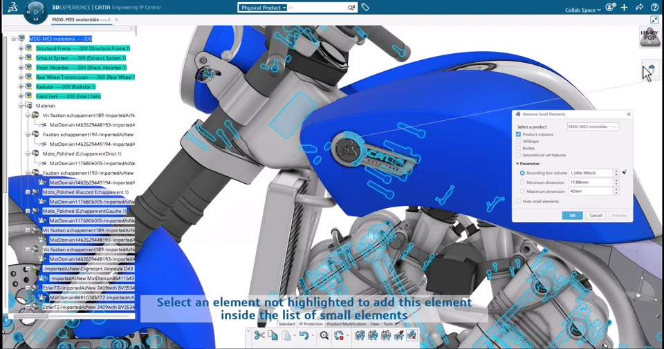

Hello everyone,
You will find below a video and document to present the new command Remove small elements.
This command will allow user to better hide the intellectual property inside a model and reduce the data size.
It will assist the suppliers and customers who would like to opt for removing small elements in the filtered product and save a lot of time to reduce the data size.
The function supports following 4 options:
-Remove Small Product Instance
-Remove Small 3DShape
-Remove Small Bodies
-Remove Small GS/OGS
