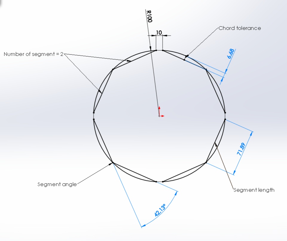

“Generate Lofted Bend” option available in the Canonic Hopper, facilitates the user to get more control over the faces of the lofted bend by providing various approximation options. The two profiles (either both open or both closed) lying on different planes is considered as inputs and two distinct points on each profile should be selected as reference opening points. The transition between two profiles is approximated by following four methods:
- Number of bends- sets the number of bends between the transition
- Segment length- specify the max length of the linear segment
- Segment angle- specify the max angle between two adjacent linear segments
- Chord tolerance- specify the max distance from arc and linear segment

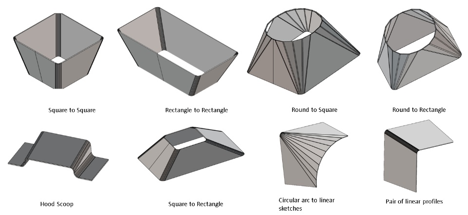

Example models that can be achieved from this highlight
