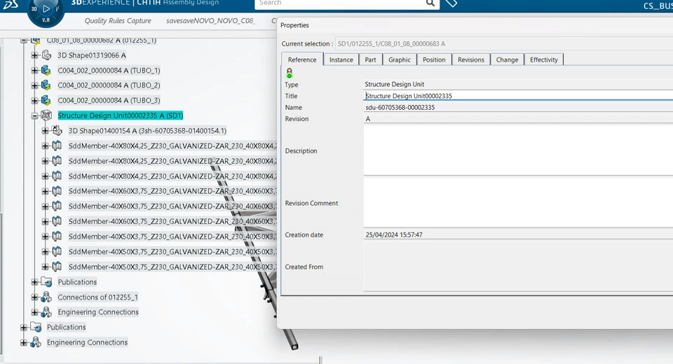

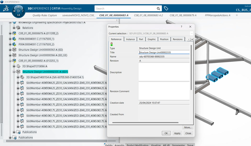

I would like assistance with an issue I'm encountering. During the duplication of a set via a native webservice call (/resources/v1/modeler/dslc/duplicate) of a top-level item, the objects of type Structure Design Unit internally are not duplicated, even though the duplicate option is activated. They maintain their link to the original context where they were created. Is there any option to address this issue?"
