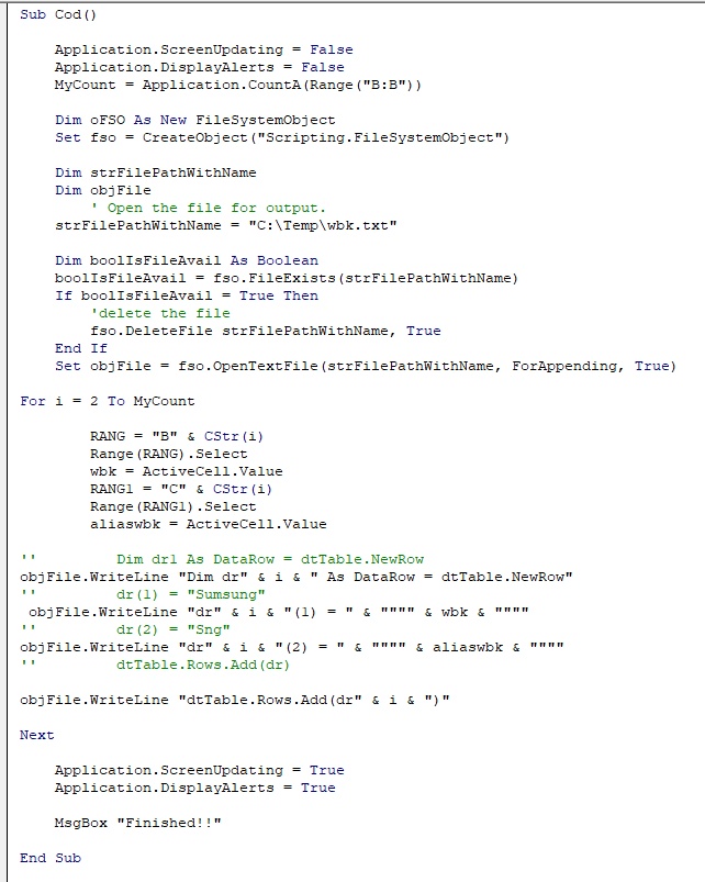

To do this, I used an Excel macro to generate a txt file with code to be used in vb.net. Of course, this was my choice because I wanted to do something which I didn't do before, it can be done in many other ways, easier or faster, so, please, understand me :).

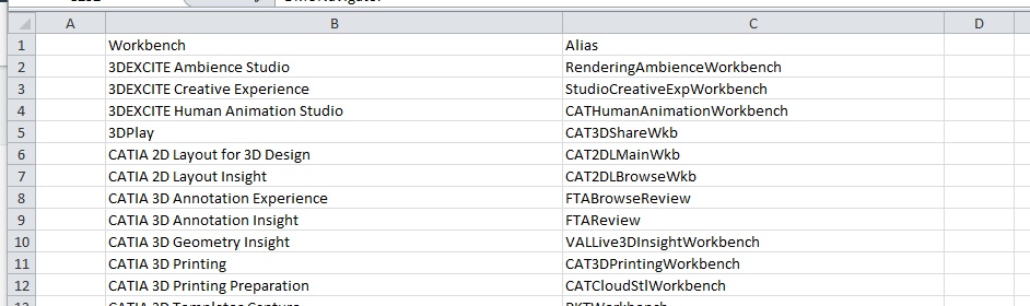

The Excel file is looking like bellow with a macro inside which is generating the code to be used in vb.net (you can also import the Excel file directly to be used by vb.net but this is another story).

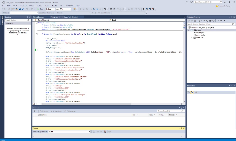

And how is looking in vb.net
