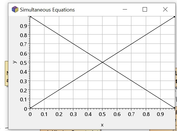

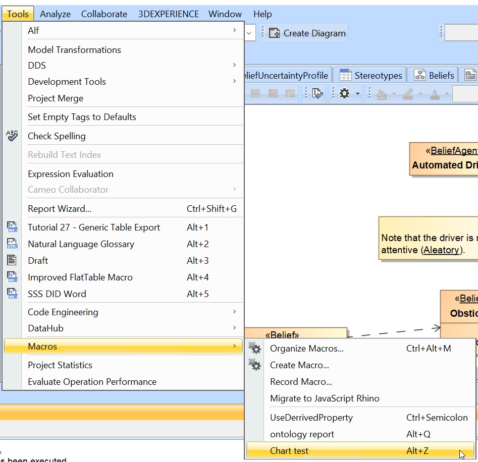

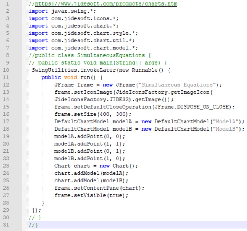

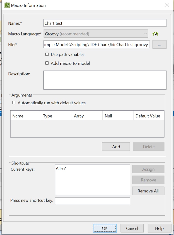

Here is a simple example taken from their documentation that has been modified to run as a Groovy macro. It launches a graph in a window. Note that the commented lines were to convert to Groovy and run via the Macros, but everything else is the same as the Java example. The only other change was to change the frame.setDefaultCloseOperation() to DISPOSE_ON_CLOSE so that when the window is closed, it does not close the tool.
Note that I have not included the script (Groovy scripts can't be shared in Platform, so just an image), but I can share the code on request (it is in the JideSoft Chart manual in this link https://www.jidesoft.com/products/JIDE_Charts_Developer_Guide.pdf).
