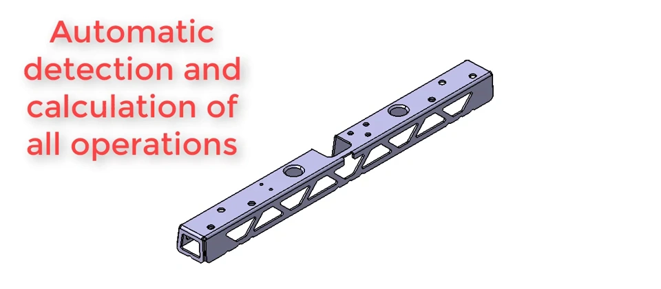

This App is call D2C (Design to Cost) whose objective is to analyze automatically all the operations from Parts & Products to show their costs analysis at an early design stage, so the designer will be able to look for more optimal alternatives, within the target costs.
D2C automatically knows the model type based on its technology (Sheet Metal, Machining, Casting, Plastics, Gaskets, Profiles, Tubing, Composites and Ceramics).
It verifies each Part-Number in the company's Oracle DB, obtaining prices and previous purchase history, if it exists.
It also automatically calculates and creates the welding of Parts & Assemblies based on specific algorithms, materials, clashing, types, etc., and surface treatments (painting, coating, sandblast, etc.).
