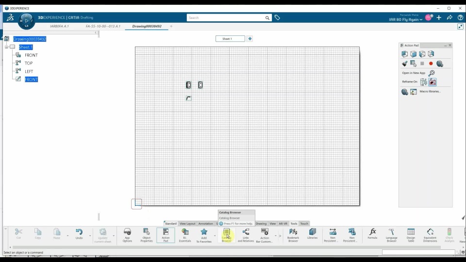

The drawing frame and title block can be inserted into CATIA in different ways. These elements can be customized as desired. For the IAR80FA project, we will use something closer to what is known in the Romanian aviation factories and we decided to use the model below. The insertion method used is simple, by using the elements introduced in the catalogs. We have introduced a so-called 2DComponent that we will use in our drawings. The video below exemplifies how to use it.
