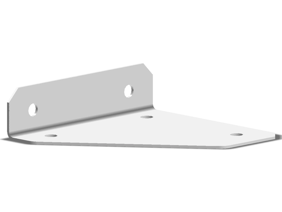

This video builds on our generative design tutorials, walking you through the process. We start with a linear static analysis and define optimization constraints. Then, we generate a concept shape—a solid body with editable sketches—giving you complete design control. Fine-tune the geometry within these sketches for your ideal configuration.
See bead optimization in action! This video shows how the app creates efficient designs, achieving a 73% stiffness improvement while maintaining consistent mass. We'll show you step-by-step how to use the 3DEXPERIENCE platform to achieve these impressive results so you can implement it into your product development.
Try It Yourself!
Ready to try bead optimization? Download the CAD model and simulation files below! You'll need the Structural Generative Designer (SGD) role. Experiment with bead layouts and different loading conditions.
