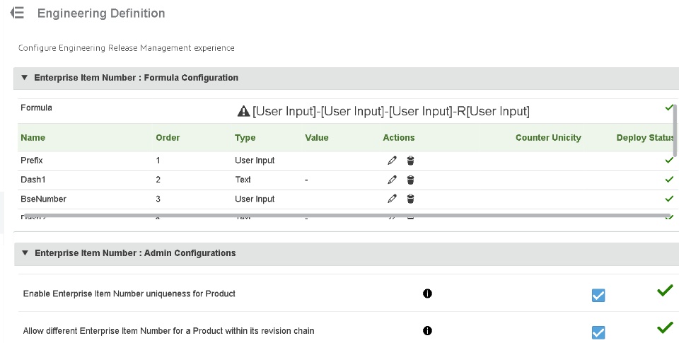

EIN definition
Let say that my EIN definition is as bellow:

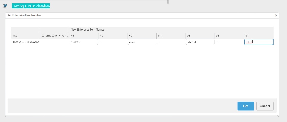

So when I use the function to define the EIN I have the following dialog box:

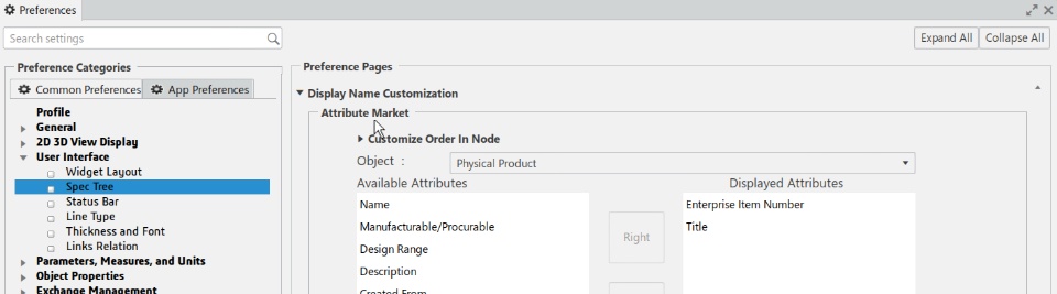

I can change the preference to show the EIN in CATIA:

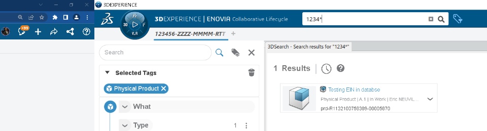

Searching for EIN

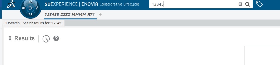

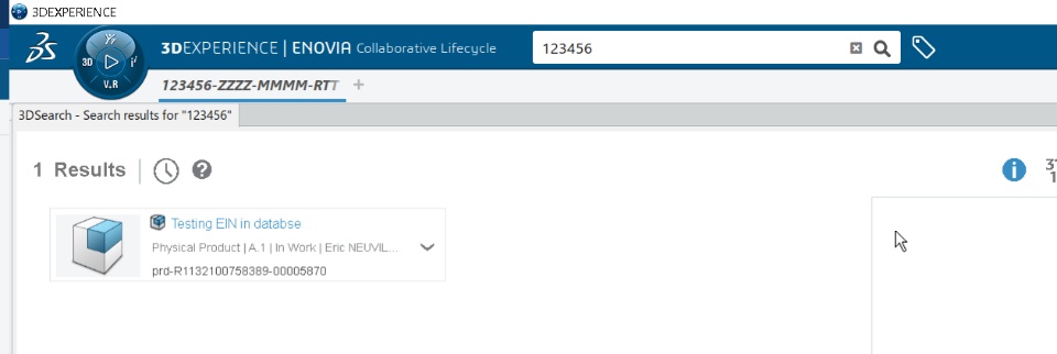

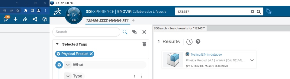

If I search for 12345 I have no result
but if I search for 123456 I have my result

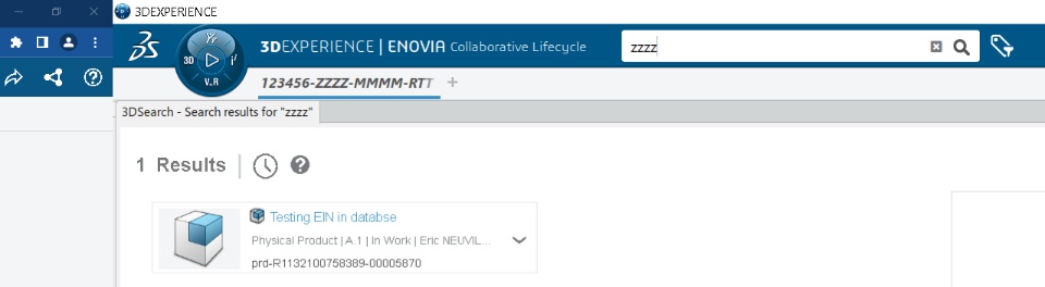

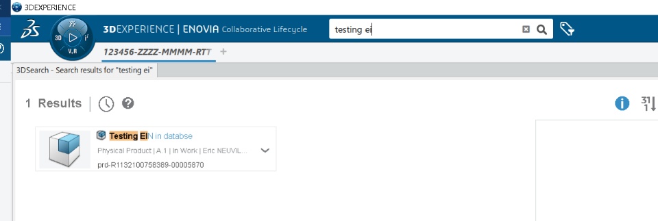

So it seems partial search on EIN does not work as it does on Title

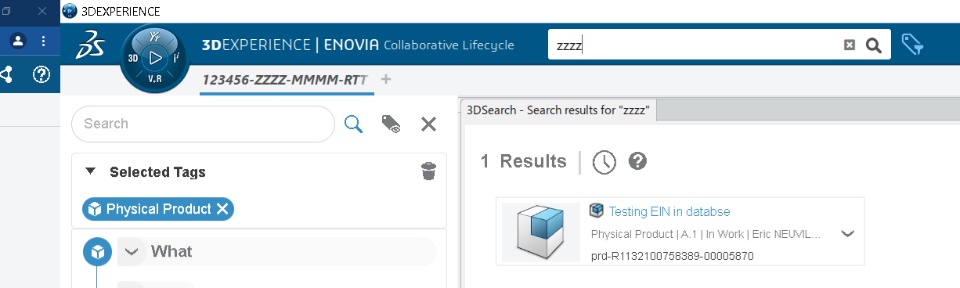

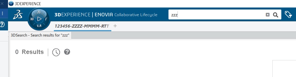

if I search for zzz I have no result
but search for zzzz does provide a result
ATTENTION

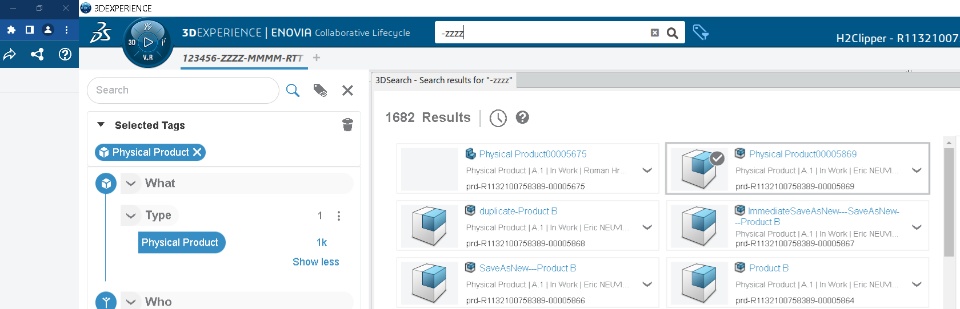

searching -ZZZZ will not find the result as searching with - actually remove matching objects from the result.
so searching -zzzz will exclude anything that does have "zzzz" and this is the EIN I am looking for!

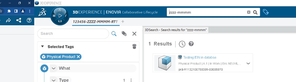

but searching zzzz-MMMM will work

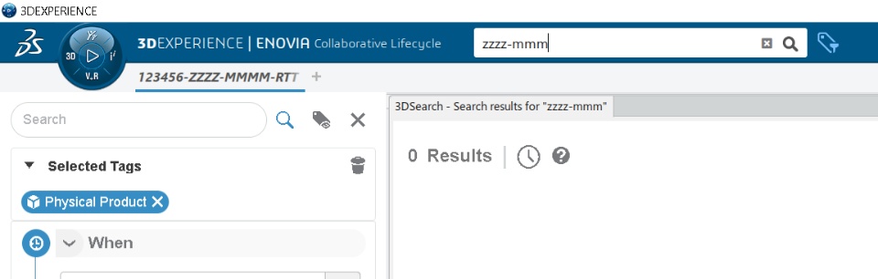

Again ZZZZ-MMM will have no result

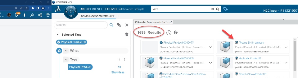

searching -ZZZ will provide more but will include my product
as expected searching -ZZZZ will exclude the file I'm looking for
So how to search EIN in database?
Remember the sections of the EIN and either fill a full section
or part of it with * or ? to complete the number of character in the section
Hope this help
