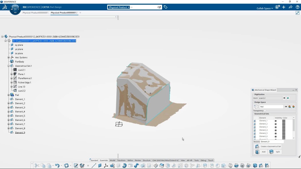

This is a simple example of a full process covering part scanning, reverse engineering, printing preparation, actual 3D printing and shape control. It implies the use a a hand scanner and a 3D printer, both of them available at DS site in Aix en Provence. It also shows an example of using reverse engineering applications Digitized Shape Preparation, Digitized Shape to Surface and 3D Printing, all of them available for example in role RPE.
