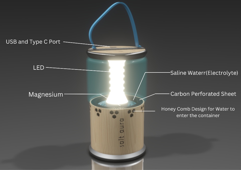

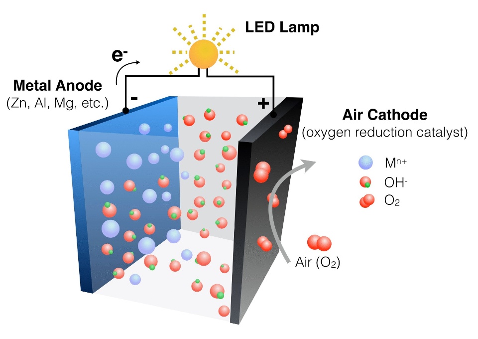

The secret behind Salt Aura's reliable energy production lies in its innovative ionization process. Electrolytes in the saline liquid react with magnesium within the device, generating a steady flow of electricity. This chemical reaction has been optimized to ensure sustained energy production over an extended period, providing a dependable power source for the integrated light.

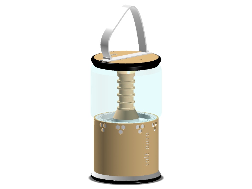

Crafted with both functionality and aesthetics in mind, Salt Aura features a sleek cylindrical case made of wood. Its base houses the integrated circuit, while the perforated cap on top facilitates the entry of water for the ionization process. The cap also allows for the safe escape of hydrogen gas produced during the reaction, ensuring efficient and safe operation.
The Working :
Saltwater and magnesium light refers to a type of lighting technology that utilizes the reaction between saltwater (saline solution) and magnesium to produce electricity and generate light. This innovative approach provides an alternative source of illumination that can be used in various applications, particularly in off-grid or remote areas where access to traditional electricity sources may be limited.
The process involves an ionization reaction where the electrolytes in the saltwater, along with magnesium , create a chemical reaction. This reaction generates a steady flow of electricity, which is then converted into light through the use of light-emitting diodes (LEDs) or other light-emitting mechanisms.
One notable advantage of saltwater and magnesium light is its sustainability. Unlike traditional lighting sources that rely on fossil fuels or require frequent battery replacements, this technology harnesses the power of natural resources and can be considered a renewable energy solution. Additionally, saltwater and magnesium lights often have a longer operating time compared to other portable lighting options, allowing for extended use without the need for frequent recharging or replacement.
Mg + 2H2O → Mg(OH)2 + 2H + 2e-
1/2 O2 + H2O + 2e- → 2OH
2Mg + O2 + H2O → Mg(OH)2
