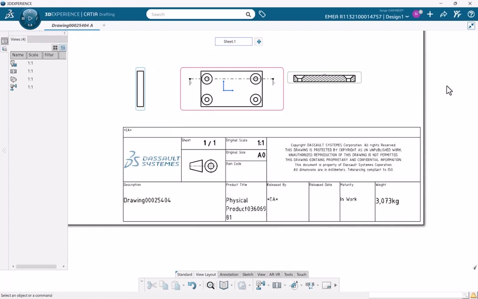

Did you know that since R2025 FD01 level, it's possible to include in drawing title blocks the Release information such as:
  • Date on which the drawing is set to Released status
  • User who has set the drawing to Released status.
Those attributes are dynamically evaluated when opening or exporting the data (example: Drawing export as .pdf).

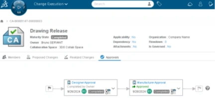

It's also possible to get into the drawing information about the Change Actions (CA).
To do so, you have to use the Link Template/Insert Attribute Link command and click the Extended attributes icon.
You will see an example in the video below.
