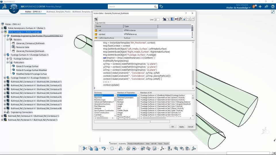

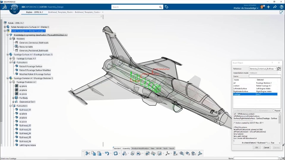

This automation role's functions, like template creation and generation of components through script, capitalizes on the strong parametric and relational capabilities of the 3DEXPERIENCE CATIA Mechanical and Shape Design applications.
Here are then :
  • a presentation of the concepts used by Rohan,
  • and a video of this demonstration in which you will discover how it is possible to create new Bulkheads Parts of an aircraft, reusing, thanks to a template, an existing design which is linked to surfaces and plane published in a Skeleton Part.
