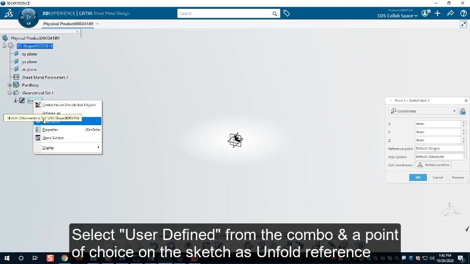

SHM_RolledWall_Enhancement
This enhancement allows the user to define/select an unfold reference point on the input sketch for Rolled Wall feature. Before this enhancement, user could only select the sketch start point/sketch end point/sketch mid-point as an unfold reference.

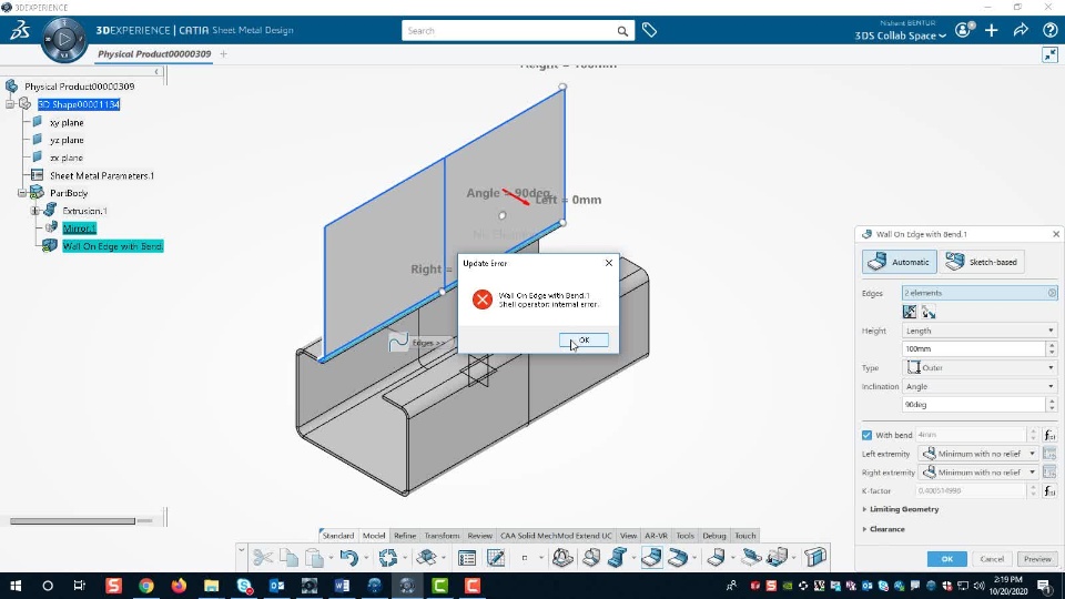

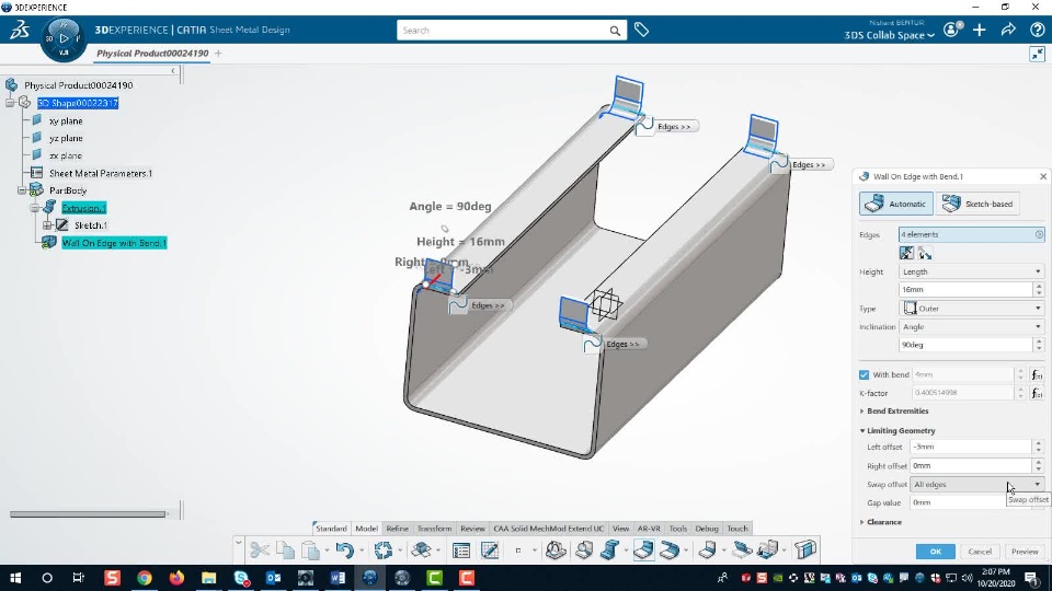

SHM_WOE_R2021xFD02
When a multi Wall on Edge (WOE) is created, the user has a capability to swap the limits of each edges independently among the selected edges. Earlier to this enhancement, limits of all the selected edges were swapped.

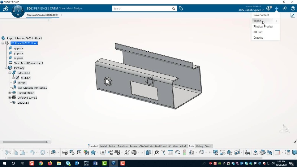

SHM_ Mirror_Simplification
This enhancement targets to simplify the result faces after mirror operation. This also improves some workflows that were earlier restricted (e.g., flange propagation on the mirror body).

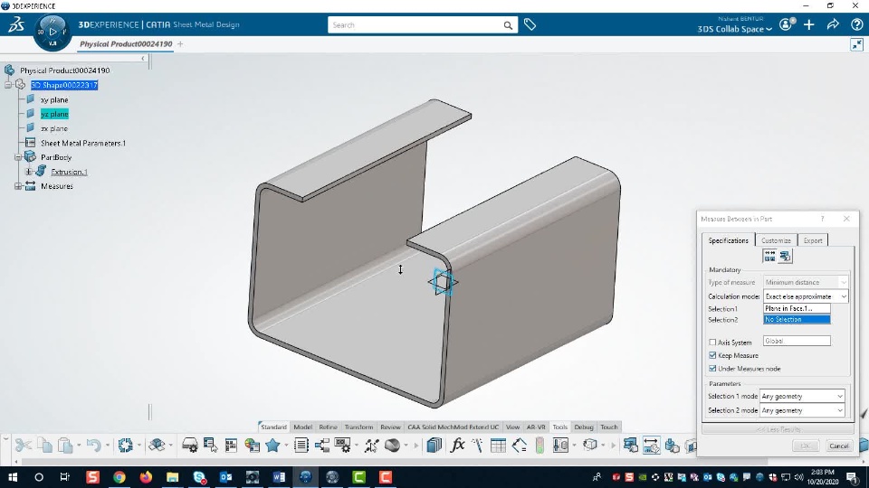

SMD_ExtrusionMidPlaneOption
With this enhancement, user can create an extrusion with a dimension equally divided on either limits. Thanks to the “mid plane” option in the limit1 combo.
