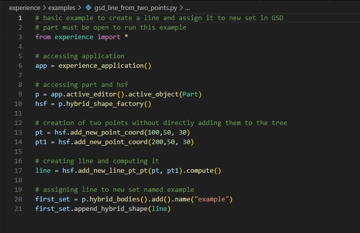

here is little example to create line through two points and assign it to the set:

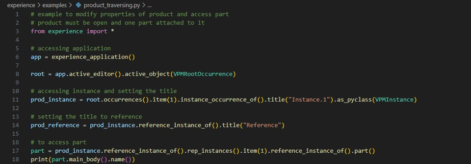

or a little snippet to traverse through the product,
