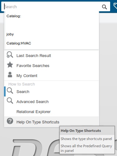

When first digging in to Data Setup for Piping and Tubing, it can take some time to become familiar with all of the different contents that are used. Here's a tip on how to find the right content type to search on - using 'Help on Type Shortcuts'
If you haven't clicked on this Help option before, it's available at the bottom of the list provided when clicking in the Search field (image TypeShortcuts-Where)

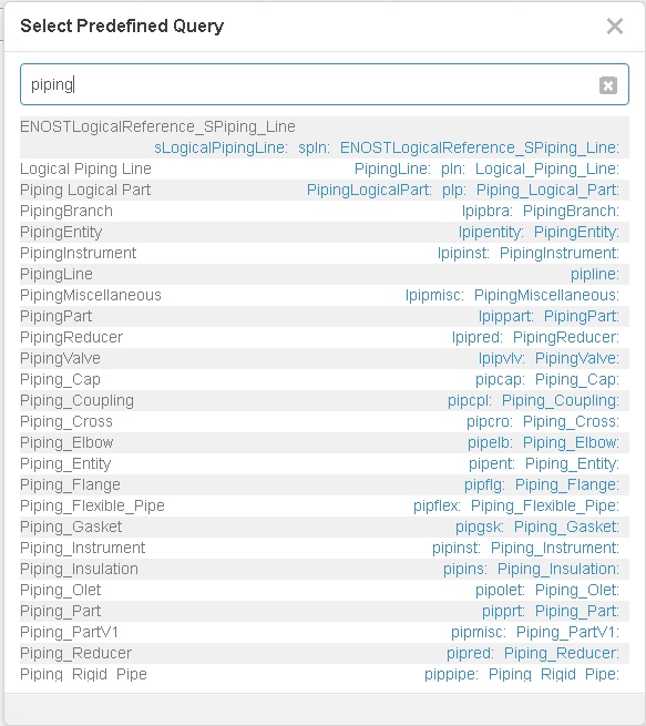

Once open a list of ALL of the content types available will be displayed. This list can be filtered by entering a value into the string search field - in my case, I entered piping to filter on all of the content types containing 'piping' (image TypeShortcuts-Contents)
