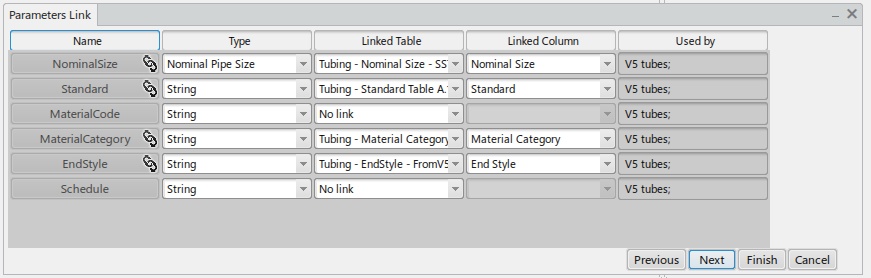

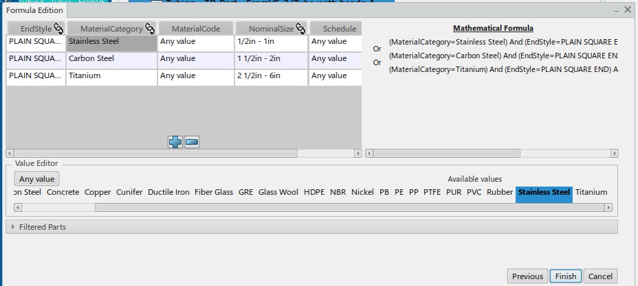

In the example here (image ParametersLink_Step1), I have set NominalSize, Standard, MaterialCategory, and EndStyle be be linked to the specified table content (see the chain icon), leaving MaterialCode and Shecdule to be searched live from the Chapter content. The results for searching the MaterialCategory table content reveals a decent list of available options (image ParametersLink_Step2a)

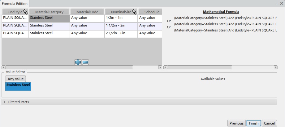

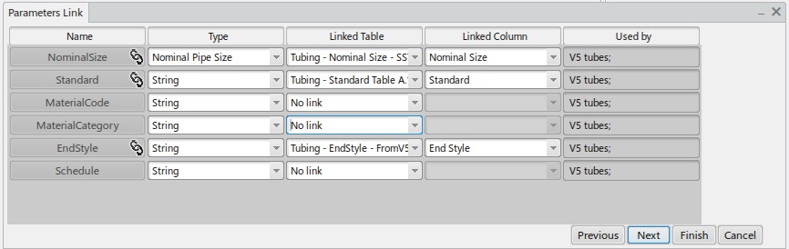

If instead I specify the search on MaterialCategory to be the live content from the Catalog Chapter (i.e. no link to the table as seen in ParameterLink_Step3) the results to filter on in this case are significantly different (image ParameterLink_Step4) and reveal that only StainlessSteel items have (so far) been added to the Catalog Chapter content
