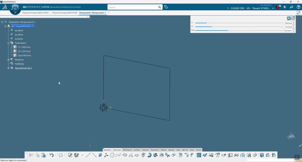

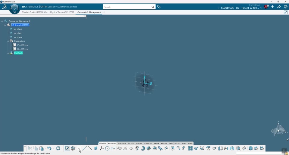

Rectangle shape and Parameters
Create one length parameter and define min and max limits. Copy / paste the parameter to create second one. Rename parameters.

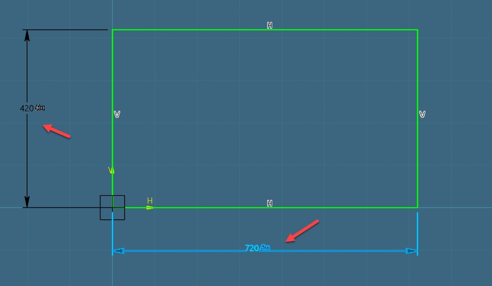

Create a Sketch with a rectangle, create dimensions link with parameters on two sides.

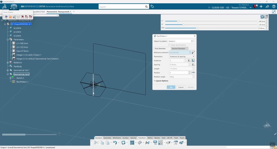

Using Rectangular Pattern, I could not find something that will update properly, or provide the required geometry with the spacing and length option so I decided to use instances and spacing option. I had to compute the number of instances (and add one for geometry/update purpose).
instance number = ceil ( length of the rectangle / spacing ) +1
The first direction for the pattern is vertical, so I create a construction line in the sketch and create its output feature. The spacing along this direction is actually the size of the hexagon.
The second direction is angled, so I again create the construction line and its output feature in the Sketch. I also create the reference dimension so I can use it in formula.
The third direction is horizontal and the spacing is defined by adding two dimensions. So I create the supporting elements in the Sketch.

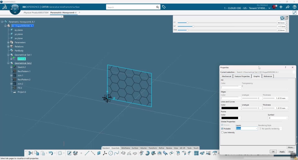

Once I have all directions as output features and parameters defined I create the first Rectangular Pattern. The join the resulting geometry with the hexagone sketch so I can pattern that again.
Finally
I put some color to make it look better
