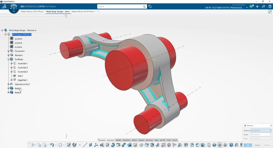

Remove
Remove the geometry of the selected body to another one

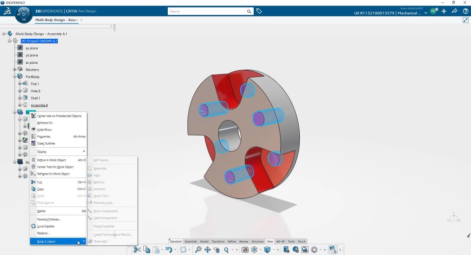

Assemble
Depending on the polarity of the body:

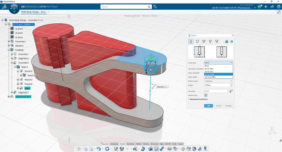

- Add the geometry of the selected body to another one if the first feature of the selected body is a positive one (such as Pad, Shaft, Rib, etc...)

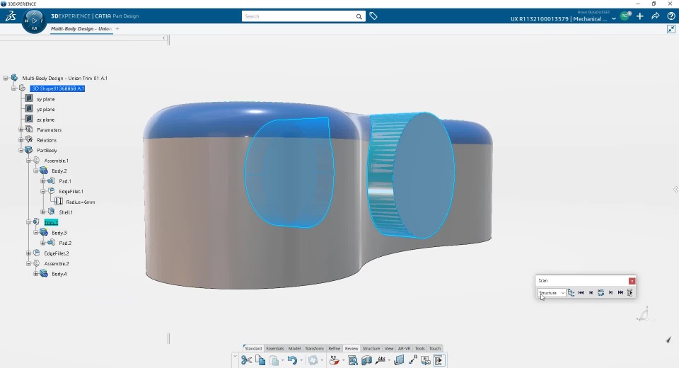

- Remove the geometry of the selected body to another one if the first feature of the selected body is a negative one (such as Pocket, Groove, Hole, etc...)
This boolean operation is very useful when, for manufacturing reasons, user wants to create one (or several) body(ies) containing feature which remove material.
Of course, each time a feature is added into (or removed from) a Solid Body, the geometry of the Part is automatically updated.

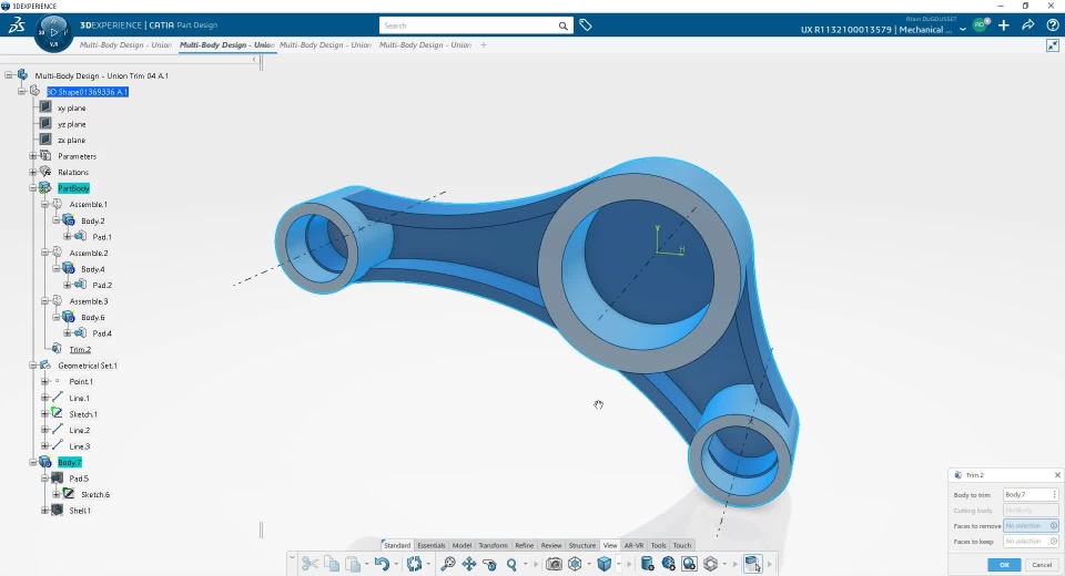

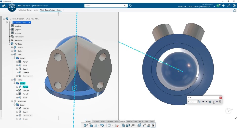

Union Trim
Merge the geometries of Solid Bodies allowing the users to specify which area(s) has(ve) to be kept or removed.
I really like this powerful capability, which allows the user to easily create complex geometries.
