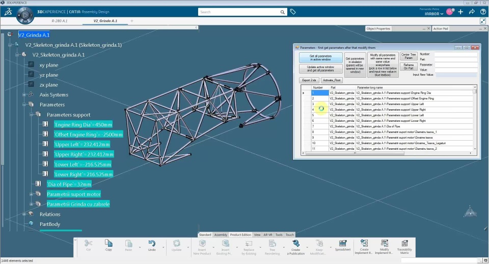

Modify parameters with vb.net in 3DEXPERIENCE
An example of using vb.net in CATIA 3DEXPERIENCE, pick some parameters in a skeleton in datagrid, then search all structure for that parameters and modify everything with the new values, finally, update everything with a separate button. An export of all parameters can be done also to excel.
