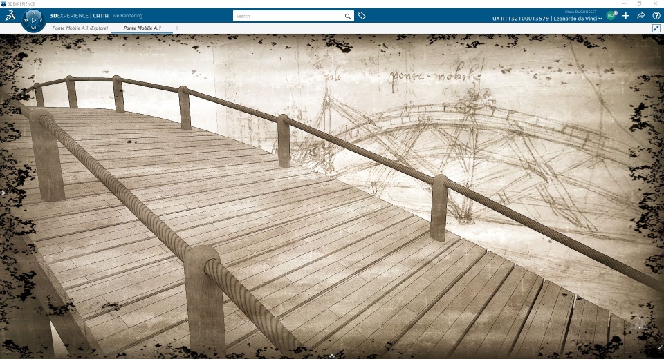

Codex

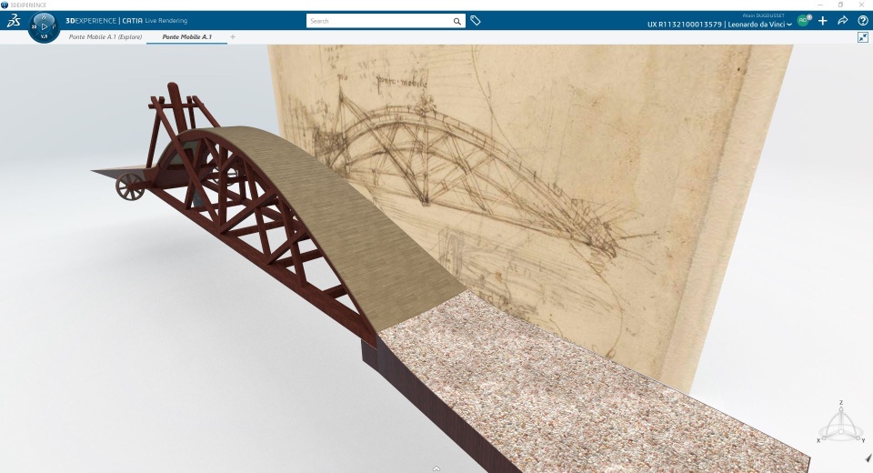

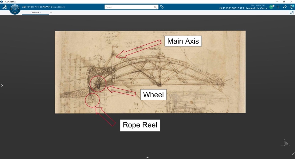

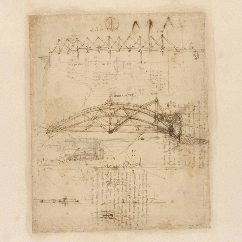

Leonardo's swing bridge concept can be seen on the codex folio 855 R http://codex-atlanticus.it/assets//2000/000R-855.jpg
The Concept
Looking at the codex, you can see of course the bridge itself with its main axis.
But if you look in details, 2 wheels and 2 rope reels are visible too.

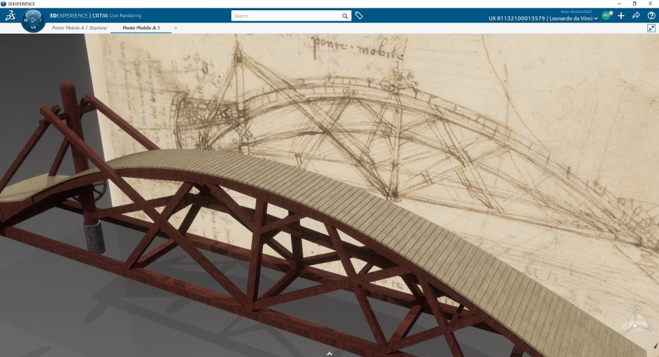

The Bridge

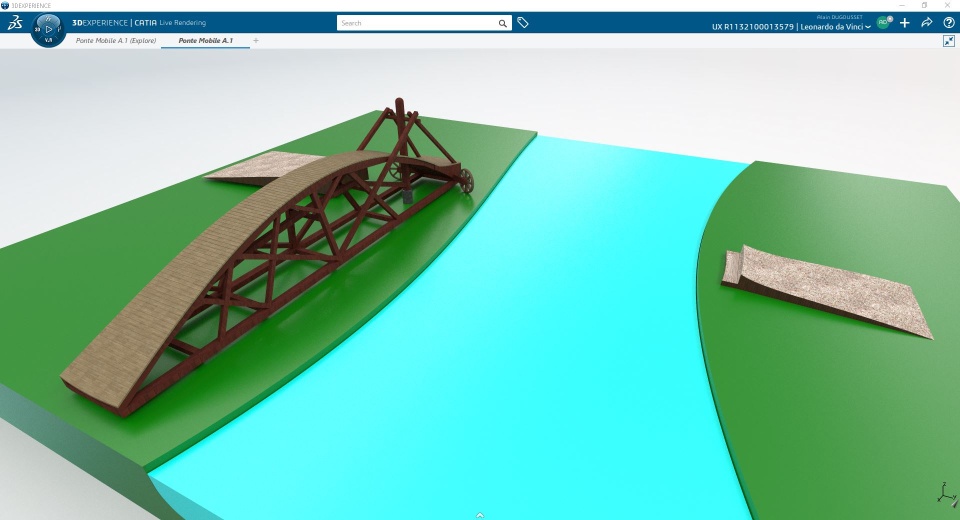

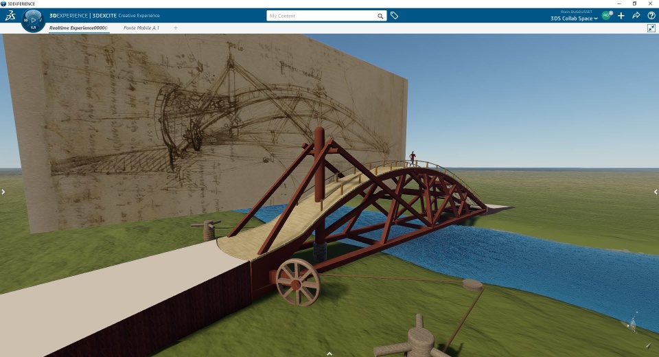

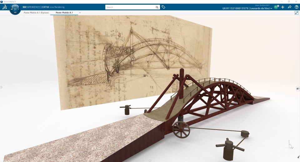

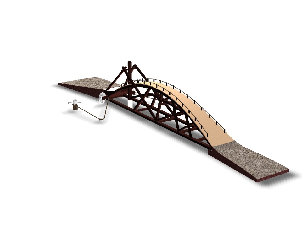

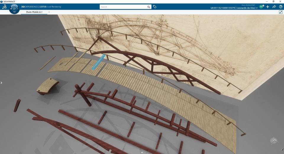

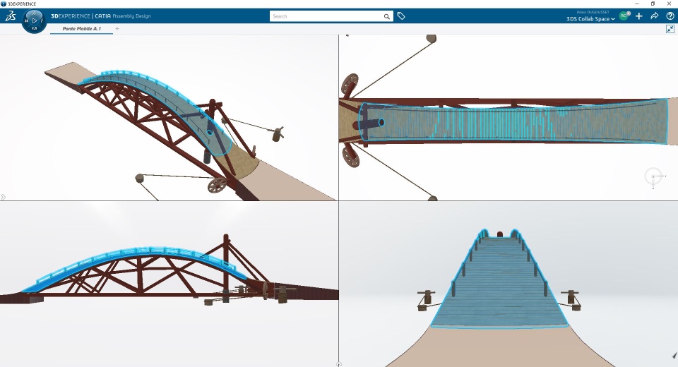

The first step for me was to start by designing the bridge as an assembly of wooden beams and plates thanks to CATIA applications (Assembly Design, Part Design, Generative Shape Design, etc...).
Each beam, each plate, each rope, etc... has been designed as "unitary parts".

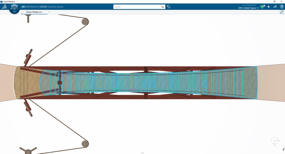

In order to allow the junction between the main pillar (the rotation axis) and the 4 mains beams "supporting" the bridge, the width of the bridge changes over its length.
After this step, I added

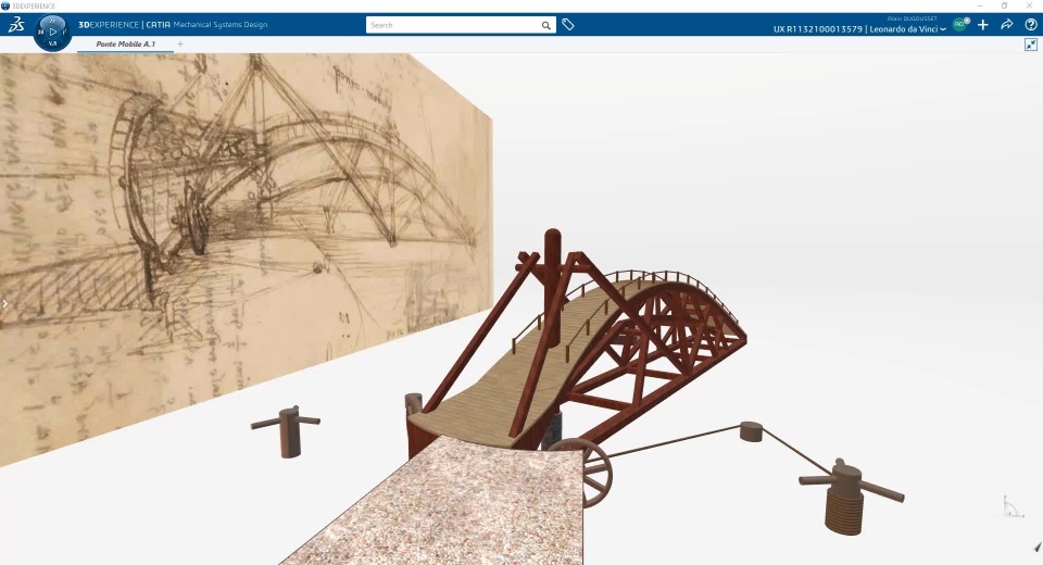

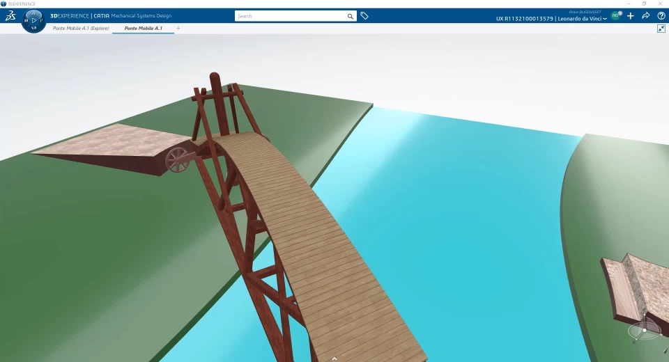

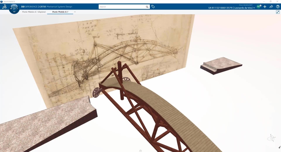

  • two ramps (in stone), and checked that the rotation of the bridge is possible (using CATIA Mechanical System application)
  • and basic land and river 3D representations

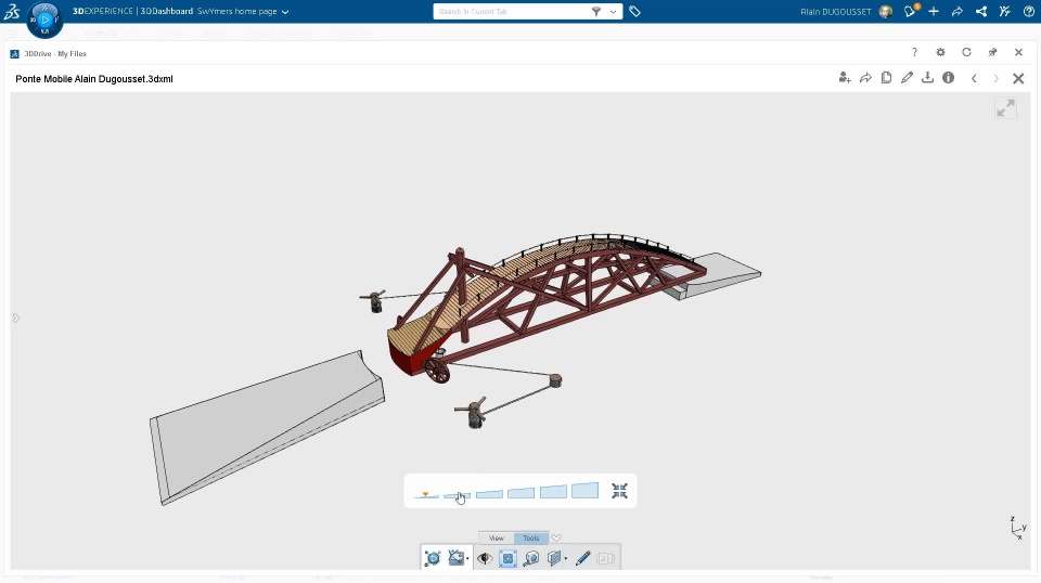

The Rotation System
Looking at Leonardo's sketch, I could imagine a possible rotation system for his bridge, using 2 rope reels (one on each side of the bridge).
The bridge is then able to rotate around its main axis "on its 2 wheels".
The Digital Mock-Up
Here are the 3D CATIA data of this Swing Bridge.

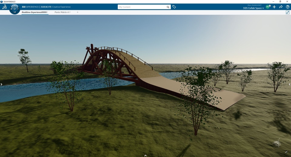

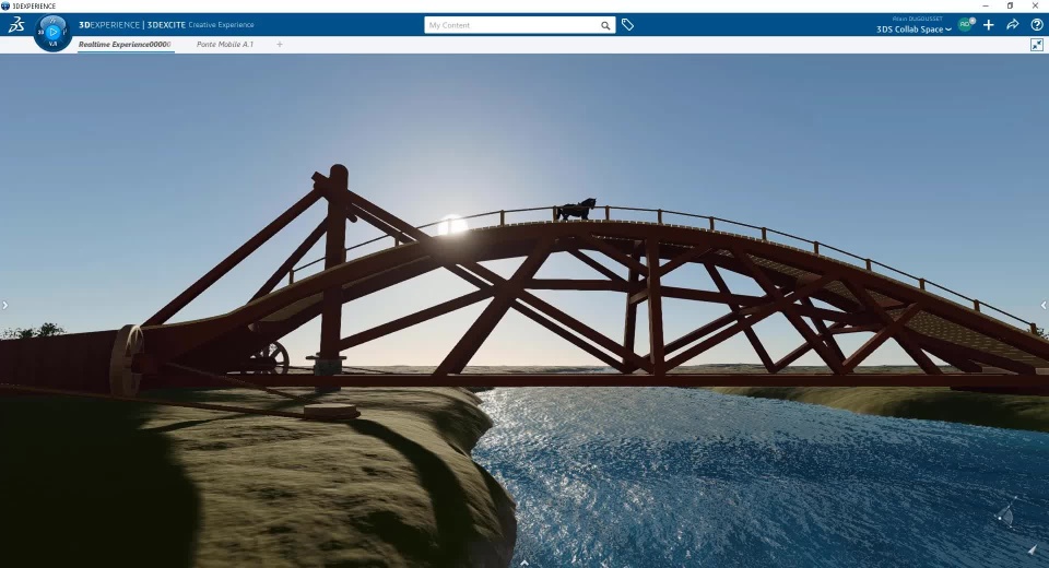

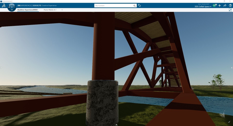

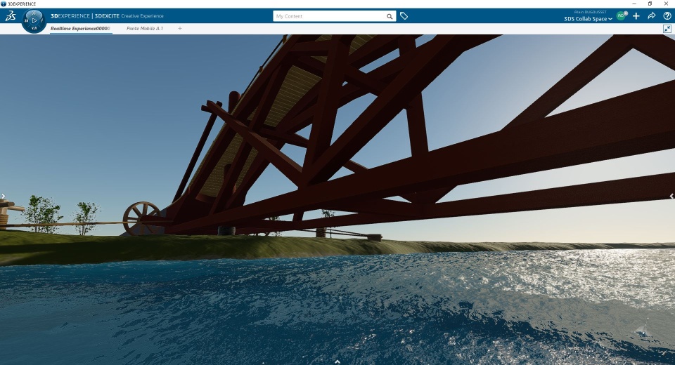

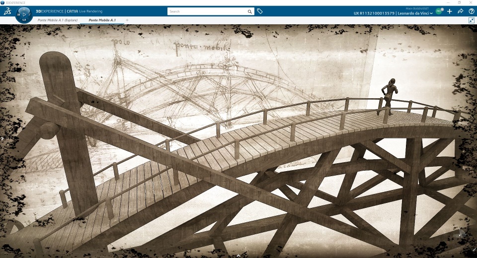

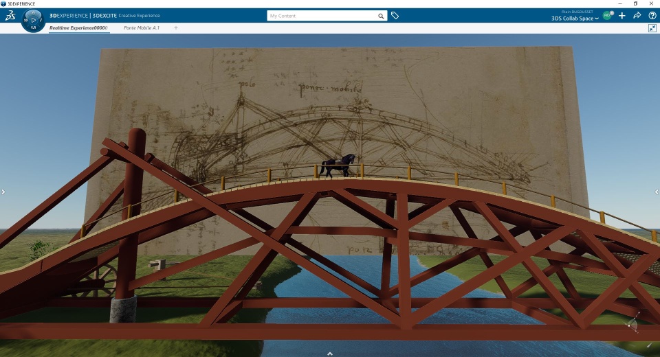

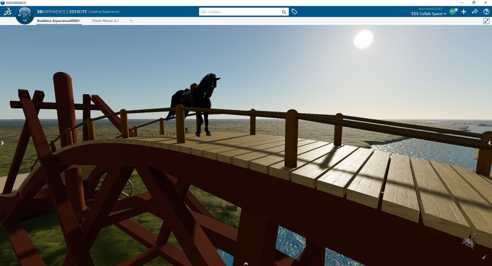

Using 3DEXCITE Creative Experience and Planet Studio application, I finished my project by creating two simple experiences:

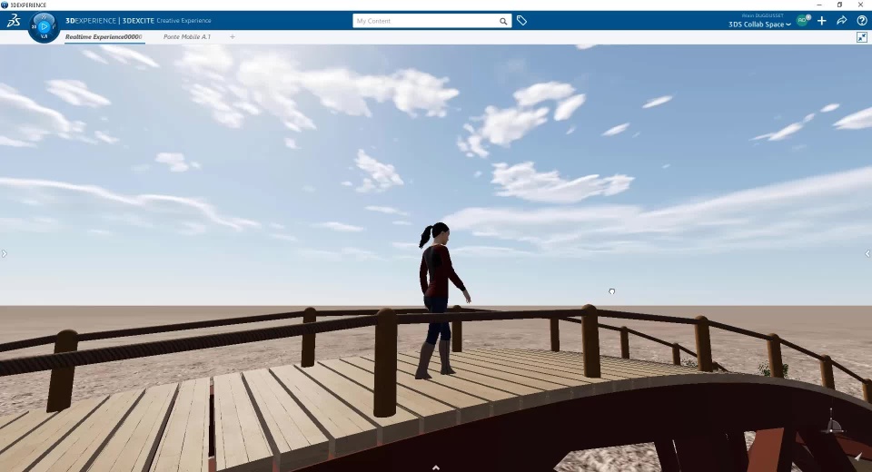

  • the first one to simulate the crossing of the bridge by a human avatar

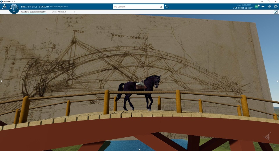

  • the second one to integrate my design of  Leonardo Swing Bridge into a virtual universe.
In this experience, I added a horse on the bridge, as Leonardo seems to have drawn one on his sketch.
