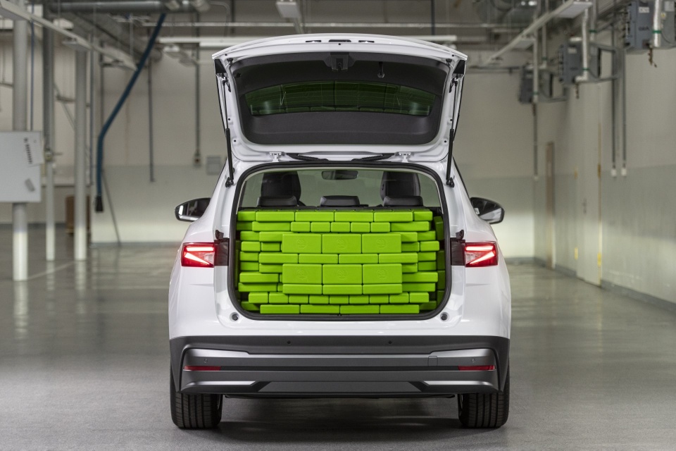

VDA method :
Short for “Verband der Automobilindustrie”. This is the German method and involves filling a load space with 200x100x50xmm blocks, then counting those blocks.
200x100x50xmm = 1 litre so you can see how the total is calculated.
This is typically more practical as these blocks are relatable to real life things you might want to put in a car’s boot. Manufactures using the VDA method
#bmw ,#Honda ,#Kia ,#Mazda ,#Toyota ,#Hyundai,#Audi
It's important to note that this method is not 100% accurate, as there may be irregularities or contours in the boot that could affect the amount of water & block displaced . However, it can give you a good estimate of the boot capacity of your car.

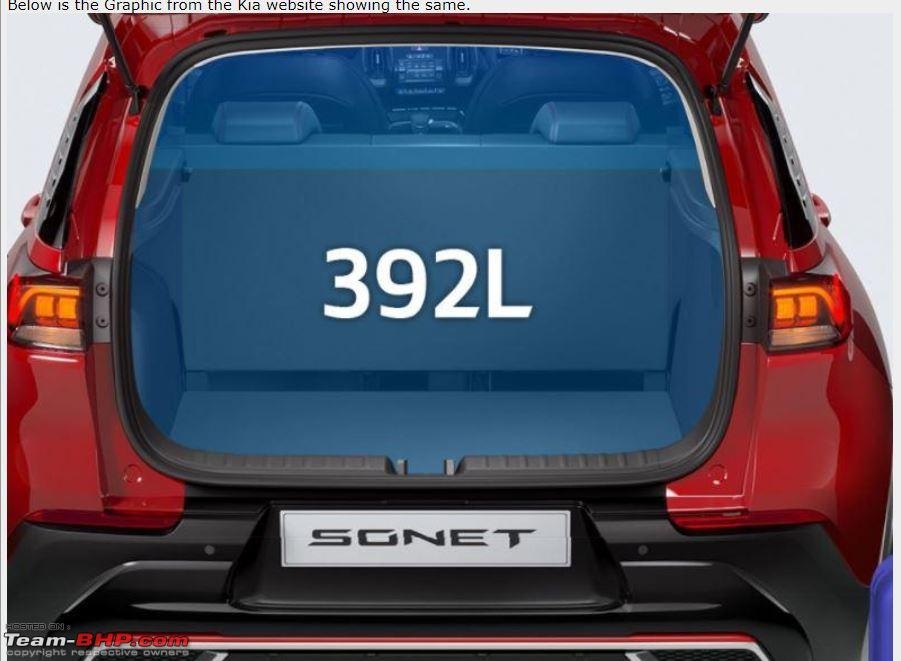

💡I hope that in this thread gradually users will put their own measurements of their cars for the benefit of others so that users can know the actual boot size measurements.
💡Facts:Did you know boot space in many cars is much smaller than claimed in their brochures.
