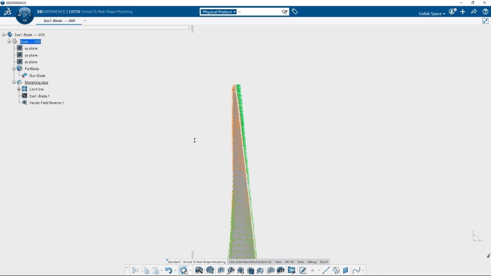

The purpose of this post is to show how the VSO application has been drastically modified in release 2022x, with new possibilities but also with a complete change in the user experience which results in a change in the user process itself.The result is an application which can do more in a easier way, but also which is more stable and reliable. The attached video gives an idea on a simple case of what the new user experience looks like, with a wizard to help users through the whole process.

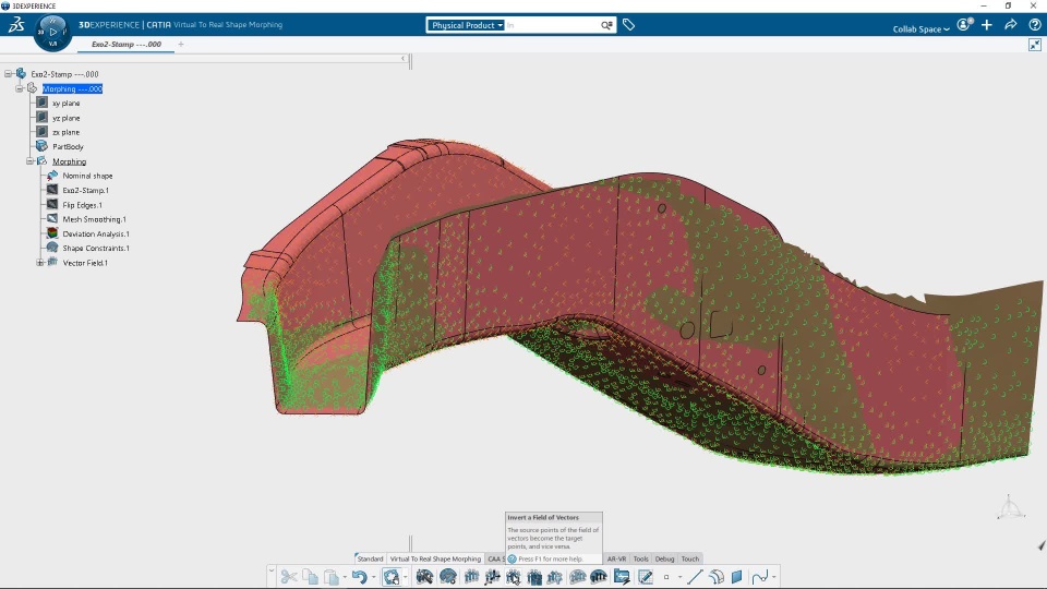

This second video shows a more difficult situation, where the morphing to apply has to be generated from a 3D scan of a real
part. It shows the benefit of the full integration with CATIA Reverse Engineering applications and the unique advanced features which allow to get a high quality result event though the input digitized data is not so good.
