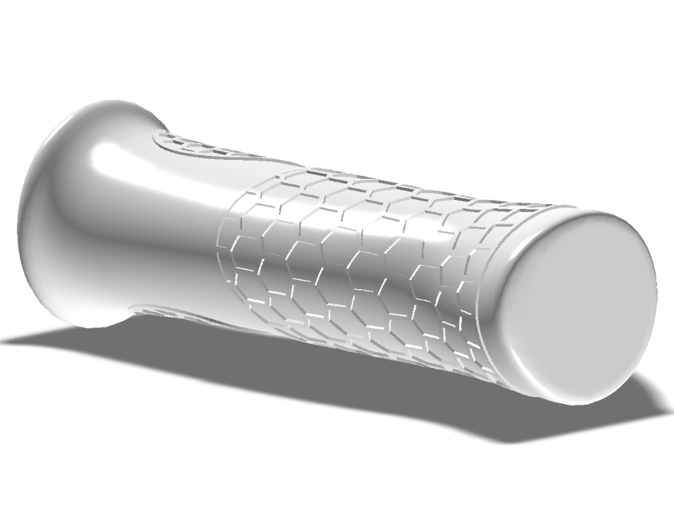

Take a sneak peek at our design below, and we'll show you how we created it on Thursday!

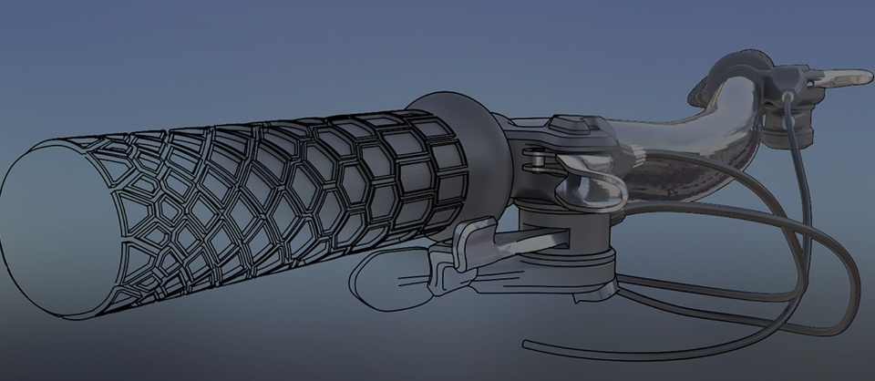

| Could you control the depth of the pattern? Perhaps going from negative to positive along the grip? | Absolutely. Within the workflow we can setup ways of varying the pattern depth. For instance, for the spiral pattern the grid of points could have an offset dimension which varies. This would allow the tubes swept along the wireframe to come in and out of the grip body. Then we could have both a Remove for cutting and an Add for combining the portions that rise out of the grip. Thanks for asking. It's a cool idea. |

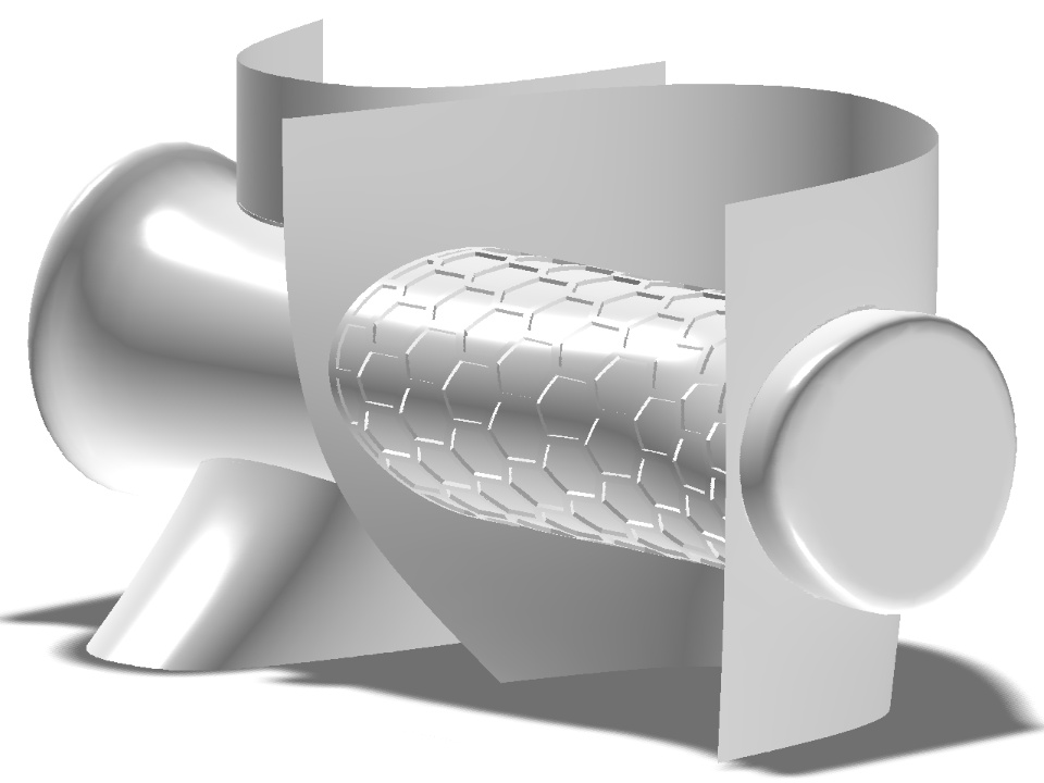

| how would you guys apply this 3D pattern model shaping to something like a stent for medical device applications ? | You could absolutely create a stent with this. I was asked to make a stent in SOLIDWORKS once and it was actually extremely complicated, especially if you want to show the stent in different positions. You could create a surface that represents where the "mesh" of the stent will be and then create a pattern that represents the shape of the actual material. It would be almost like the spiral pattern Nuri created on the surface, but instead of using the swept tubes for a cut, you would keep the tubes and get rid of the surface they lay on. Hopefully that makes sense. Let us know if you want a more concrete example. |

| Is it spelled borno pattern? | Voronoi |

| How is that complex pattern going to translated to being manufactured? | That, of course, will depend on what type of CAM software you are using. The higher end tools would be able to automate the toolpath creation where the lower end tools may be much more labor intensive. It would be a great idea to try this Voronoi pattern handle out on SOLIDWORKS CAM and DELMIA roles. |
