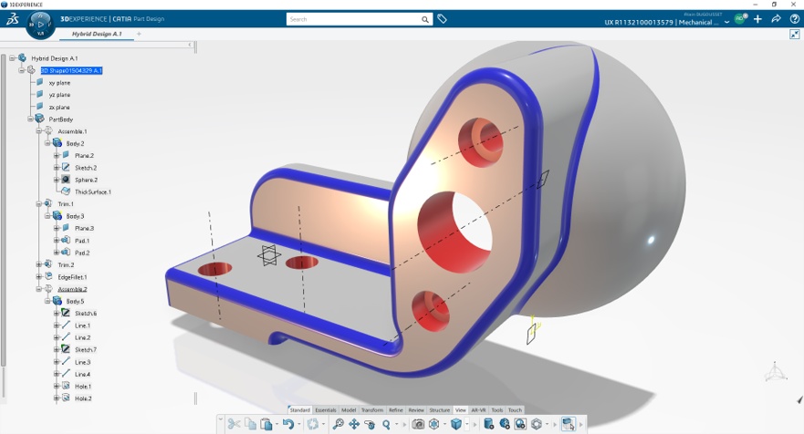

What is Hybrid Design ?

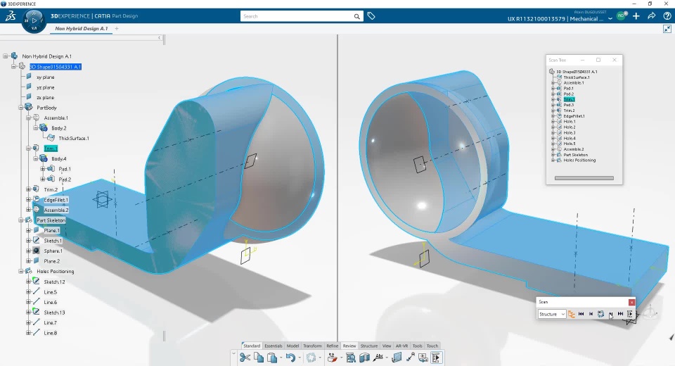

Hybrid Design is the capability to mix Wireframe & Surface features with Solid ones in Solid bodies
Note that, even when using Hybrid Design capabilities, Wireframe & Surface features can also be created inside Geometrical Sets or Ordered Geometrical Sets, depending on user needs.
If Hybrid Design is turned off, Wireframe & Surface features can « only » be created inside Geometrical Sets or Ordered Geometrical Sets, but can not be created in Solid Bodies.

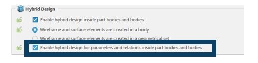

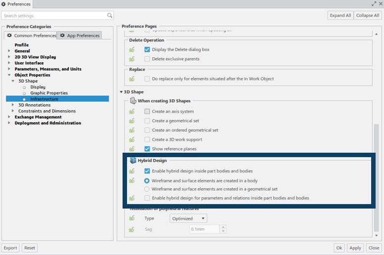

How to activate Hybrid Design ?
Hybrid Design can be activated/deactivated in Preferences / Common Preferences / Object Properties / 3DShape / Infrastructure
Note that the option “Wireframe and surface elements are created in a body” is to be used preferably to facilitate user’s understanding.

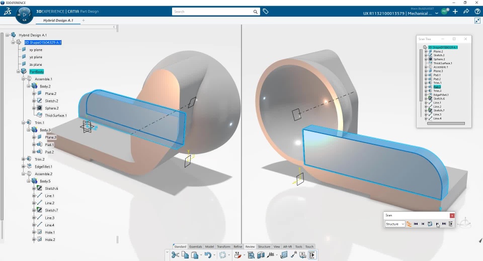

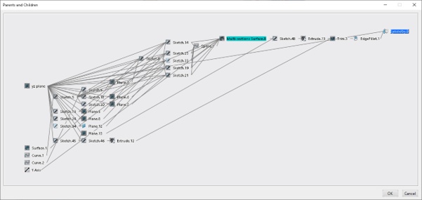

1- Ease of use of the “linear” approach
- No need to switch from Solid bodies to Geometrical Sets or Ordered Geometrical Sets depending of features types
- Only features that can be used for creating new ones are visible

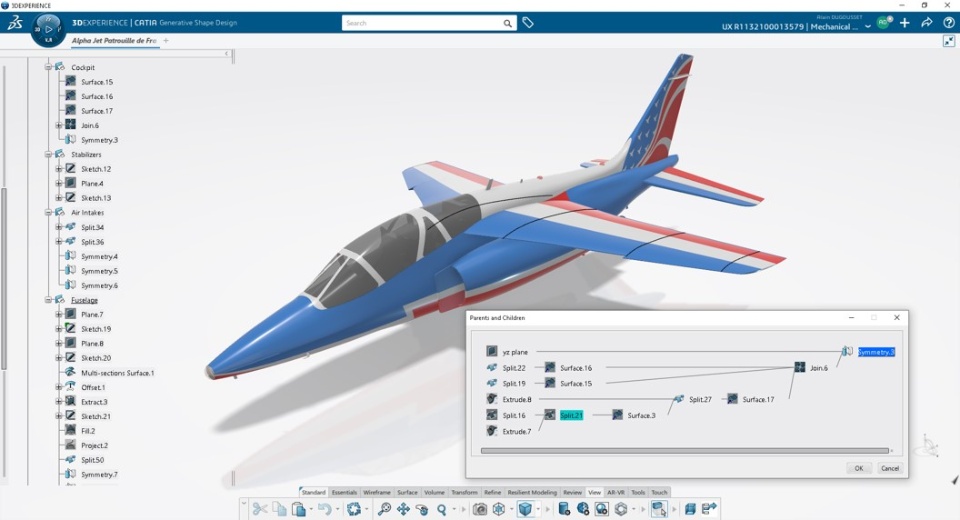

2- Ease of re-use of the “linear” approach
- “Simplest” methodology for Part reuse, either by the same user or another one.
- No need to spend (loose) time trying to understand links between features in different bodies of different types

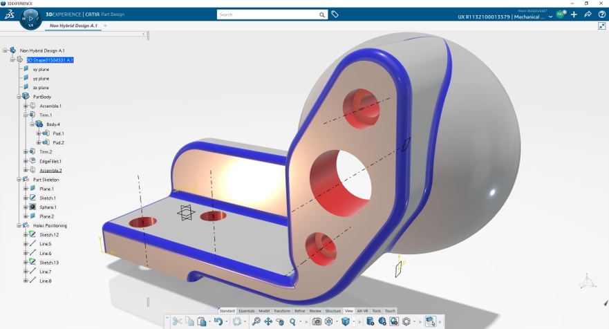

3-Flexibility for user who can mix both approaches
- Wireframe & Surface features with Solid one in Solid bodies
- Wireframe & Surface features inside Geometrical Sets or Ordered Geometrical Sets,for instance for Part Skeleton features

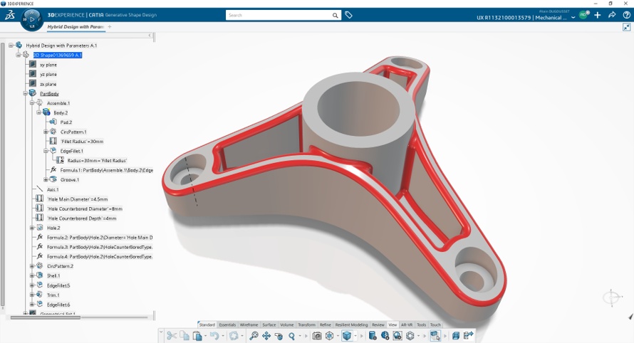

Hybrid Design and Knowledgeware
Thanks to a dedicated preference, parameters and relations can be created inside Solid bodies too.
