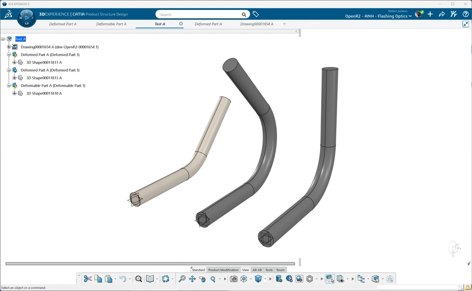

I am working on setting up wiring runs on a replica robot and I am not sure that I am 100% going the right direction.
I was able to convert a 3dpart to a deformable.
I was able to create two more 3parts and convert them to deformed and associate them to the deformable.
The Issue is that when I made a drawing I was expecting all three to show up in the BOM chart on the drawing as a QTY of 3 of the Deformable.
I am getting each of these as a separate line item as a QTY of 1.
So, I am scratching my head on what the ROI was of investing in the deformable and deformed functions if I don't have a view that shows that they are the same think as QTY of 3 but deformed in different ways.
Can anyone get me mentally over what I am doing wrong?
