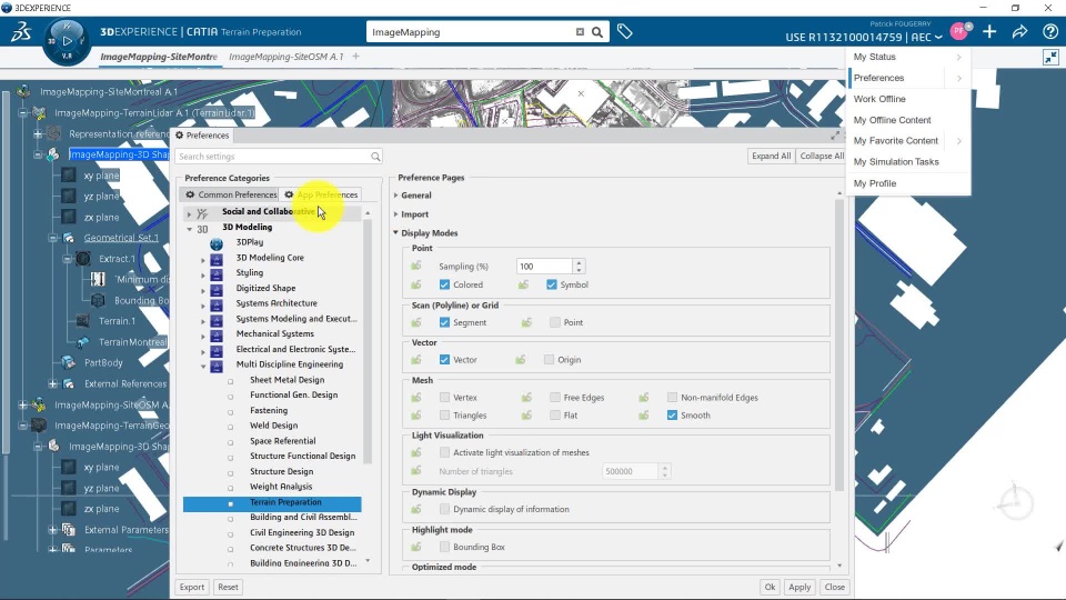

How to map an image on a terrain (3DX)
In this video, you will see different ways of mapping an image on your terrain.
1. Mapping a geolocated image as a background for your design
2. Mapping a geolocated image on your terrain
3. Mapping a screengrab from google earth on your terrain
4. Not shown here, but by combining 1 and 3, you will be able to map an image from Google Earth as a background for your design
