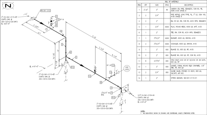

Hi. Looking for information about how to generate or draw "piping isometrics" in 3D Fluid Engineering role.
