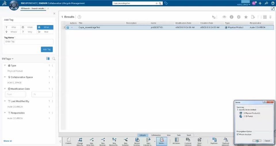

First, you have to search in the 3DEXPERIENCE the 3DPart or the Physical Product you want to delete.
Then start the Collaborative Lifecycle App, available in the North section of the compass and select the element to delete.
Finally click on the “delete” button. You can check the option named “Whole structure” if you want to delete all the parts of a Physical Product.
Your piece is now deleted, but you have to wait 5 minutes before that the server takes into account the modification. After that you can check the suppression of the piece by searching for it again.
