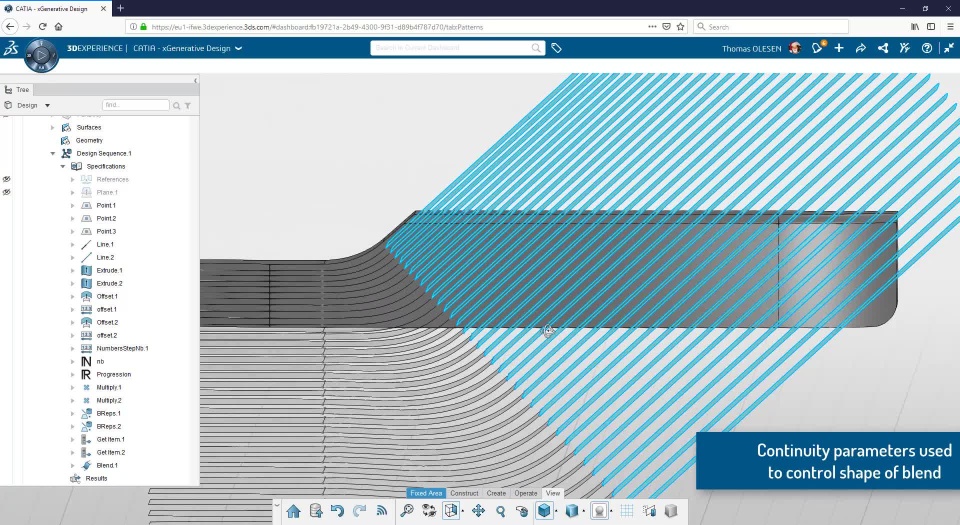

In the below example the challenge (from traditional CATIA-perspective) was primarily to achieve a progression in the two pattern domains, maintaining a aesthetic curvature across the connection between the two.
2% Progression vs 3%
The role 3D Generative Innovator is in this example utilized in combination with different native CATIA apps.
2019x xGenerative Design
