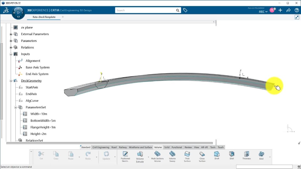

If you liked the Bridge Design Assistant and want to use it with your own template, you can find below the full workflow to make a deck UDF compatible with the Bridge Design Assistant. This is a simple profile, but you can make your own one and follow the step by step to leverage the powerful and productive Bridge Design Assistant.
This process can also be reused for any UDF you want to create (any CC&T template) and is of course compatible with the basic Component Based Design approach.
