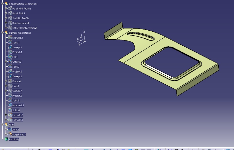

Like I posted yesterday, I try to follow, as much as possible, for what is in object
- Reference Geometries (Isolated Or datum elements, like design surfaces). This could be one or more Geometrical Sets.
- Construction Geometries. If existing. Geometries created and modified in the contest of the modeling
- Surfaces Operations I (Surfaces Features, trying to reduce them as much as possible)
- Surface Operation II (Trim and Splits)
- Join (What will become a solid)

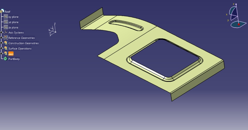

Attached to this post, you can see a simple example of a roof surface (a mid-surface of a sheet metal). Here you can see how I organized different geometrical sets and the different kind of operations I did to reach a final geometry. The goal is to have few and clear operations, easy to modify.
What do you think?
